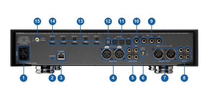

... That being the case is there any reason why the Linn streamer couldn't be used in the same way with something like the Kefs to avoid all the mucking about with active cards being inserted etc?
Yes it can be used.
Any active speakers can be can be plugged directly into the 'pre-out' sockets on the back of your Linn Akurate DSM/1 or Linn Majik DSM/2. It really is as simple as that.
Sockets 7 and 8 on the photo below are the 'pre-outs' for use with active speakers.
Domestic active speakers like the KEFs or Acoustic Energy that I suggested can be connected via socket number 8 using normal RCA cables. Active pro-audio monitors such as Genelec connect via socket number 7 using a standard balanced cable.
Simple as that. It's no more complicated than connecting a normal pair of passive speakers to an amplifier really.

That makes complete sense Steve thanks for taking the time. I have been having a look at some others and like the look if the ATC SCM19A (though would need to listen). I assume that they are the same principle in terms of how they work and how they are connected up?
The journey has just become more interesting...

I've no direct experience of using either, but whilst it is true both KEF and ATC models can be connected the same way (from the streamer pictured), the KEF alone carries its own DAC, and can therefore stream from, say, a mobile phone. By contrast the ATC requires a regular, full range analogue signal.
