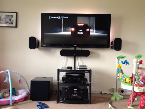

Setup my Apex last night and i was slightly dissapointed. The sound just wasnt' as open as i've had in the past. The fault most likely lays with my front two channels not being far apart enough. They sit on the wall roughly 2-3 inches either side of the tv. Bare in mind my tv is an ultra wide Phillips so not exactly small in width.
Gunna try open up the speakers another few inches tonight, see if that helps.
P.s. on a plus note, the sub is awesome :)
Any constructive suggestions are welcomed.

Thanks for the feedback atkins4725!
Personally I have no issues with the sound not being "open" or "large" enough, in fact that is probably one of the strongest attributes of Apex as far as I'm concerned, plus the "airy" and "lively" sound they produce. And my front trio of speakers are placed very closely together! Naturally what you expect to get depends greatly on your point of reference. But definitely allow them the running-in period they require (Monitor Audio say about 80-100 hrs, I say around 200 hrs) but most of all play around with placement if your room and decor allows that. Possibly look into the acoustic environment aswell. Maybe show us some pictures of your set-up and how the room is layed out.
Also, I take you have run the Audyssey calibration on your Marantz? All 6 or 8 measuringpoints? Remember to carefully re-calibrate after each change you make and especially after they are fully run-in. The effect Audyssey (and Dynamic EQ in particular) can have on the end-result is largely significant. It certainly has been on my Denon (and the Onkyo I recently tested).
BTW, it's funny hearing you say the subwoofer is awesome but the satellites a slight disappointment. For me it was the other way around as the subwoofer sounded rather "thick" and uncontrolled before it was fully run-in. Slowly it blossomed and started to impress a great deal.

I'll work on trying to get some pics uploaded, 1st attempt failed!
Audyssey was run before we watched the film last night. I'm used to having my previous floorstanders quite wide apart. Prior to the Apex i had some CM8s at home which i was considering buying, the mids & highs that are reproduced from those speakers are incredible. Maybe my ears also need to adjust to a another brands sound. I'll play around with the L&R channels tonight and see how i get on.
Thanks for the reply/help.

Not to worry, I'll do it for you :)
Look at that cute little baby to the right, hehe. That is not the AW-12 sub on the left though is it? I just remembered you had the RXW-12. Sorry, my mistake!

First, I'd advice taking the grilles off (and running Audyssey again!). Even if these are supposedly designed to affect the sound as little as possible (according to MA themselves) I'd think those might hold treble and "airy" details back a tad. I never care for grilles because they act like a veil in front of the speakers (never a good thing). Those B&W are nice, I've heard them a few times. I'd say they might be a tad "brighter" than the Apex, which are more smooth, though still highly detailed.

Ha, thanks. Thats correct the sub is the RXW-12. I'm slightly concerend that the speakers are to high. The wife was giving me jip about not having them any lower or dropping the L&R channels in line with the centre.
Ignore all the cables etc. All will be hidden and out of sight.

Your wifey might be on to something there. As for me (you might have seen my photos already?) well mine are placed slightly lower than ideal (which would be at ear height while seated) ontop my a/v cabinet and all three are aligned horizontally with each other. Works terrifically well in my room (easy to hide cables away too!). This kind of set-up does not suit everyone though (especially not if you have a little one running around touching everything... hehe).
As you can see the speakers are placed fairly close together aswell but the soundstage is way larger than what one might suspect just from viewing the photo. Also, I prefer to have the front "wall" of sound not too detached from the on-screen action (if that makes sense?) which I would probably get if I had them spread apart. Either way, my room is too small for that.

I repositioned the front L&R channels a few inches wider late this afternoon and straight away the sound is so much sweeter. (not as muddled, much clearer).
Now to re-run Audyssey and maybe a few tweak :-D
