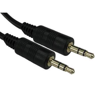

You may already have this type of lead:
(You won't want that actual one as it's 5 metres long).

Just to be clear. something like this?
Yes, TRS = Tip, ring and sleeve (the 3 separate poles)
A mono (2-pole) plug has just a tip and sleeve.
The lead you've pictured would actually work perfectly well even if Denon had used mono 2-pole jacks for the connection (in which case there would just be an unused pole on the plugs and an unused conductor core in the cable).
But you couldn't use a 2 pole plug in a 3 pole socket as the sleeve would be shorting out 2 poles that need to remain separate!
