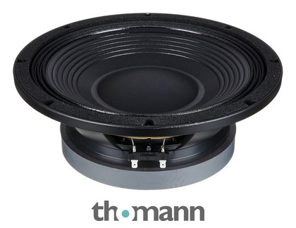

Any thoughts on B&C 12TBX100 speaker?

Received loudspeaker and I am really dissapointed. I don't know why but it doesn't sound right.
Can someone give me some thoughts why? Did I just bought shitty speaker? I build box as per manufacturer recomendation 40l net volume with port, tuned at 42HZ.
I am comparing it with Focal P20F which sounds much better in a sealed box.

What is your definition of 'doesn't sound right'?
Have you low passed the signal going into the sub?
How did you determine the port? Did you recalculate the box volume to include the addition of the port (the port should not be counted for box volume, as it does not contribute compliance to the system)?
Is the cabinet otherwise airtight?
Is the port flared?
Have you added acoustic wadding into the box?

1. I don't know, but it doesn't sound right! It's hard to describe. I can hear like mechanical noise from speaker itself. Even in free air it doesn't go low at all.
2. I am using Yamaha AS-301 sub out which I believe is 90hz.
3. I was using website to create box, which has all features, like port width and length. 40l is net volume + port. Box tuned at 42hz.
4. Enclosure ir made from MDF 18mm. Glued and screwed together. Slot port. It's not air tight because it's ported.
5. I havent added any wadding.
Even if I compare car sub (Focal P20F) and this one (BNC 12TBX100) in free air car sub plays 10x better. :(
P.s. I'm quite sure even if I add this speaker to sealed box it won't sound right.
