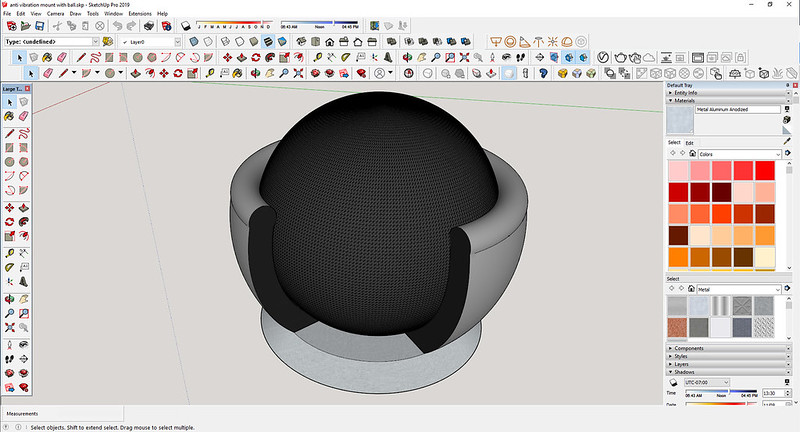

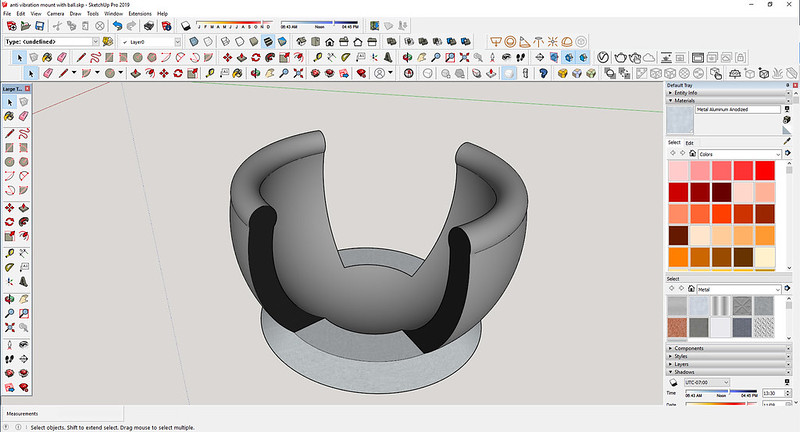

I've seen a lot of talk of people using squash balls for isolation. I designed and printed some mounts a while back to use the balls to quieten my 3D printer, and they work quite well. It's no longer resonating through the table it's sat on.
I have a few iterations... If anybody has a 3D printer and wants the .stl files, let me know and I'll upload them somewhere.
