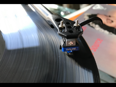

You could post a few pictures here though, in case something is obvious to us that you’ve overlooked.
I’ve attached an old pic of my Rega arm, where you can see the cartridge is ‘square’.
Reactions: Oxfordian

Sorry, should have said.
Elys cartridge replaced with a Goldring 1042 and a Lehmann Black Cube (s/h) replacing the Rega Fono.
The Black Cube is still in place and sounds just fine, the 1042 is now back in it’s case and the Elys is on the tone arm.
And, the spacer added to lift the arm has been removed.
In essence the P3 is now back to as it was when I bought it, the addition is the Black Cube.
