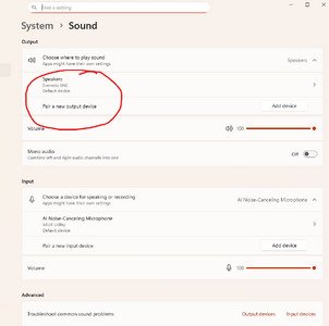

Allow me to assist 🙂
Right click your mouse over the sound icon and select sound settings
This will launch System > Sound (below)
On my Window's 11 setup you can see Eversolo DAC driver setup, the others have been manually dismantled.

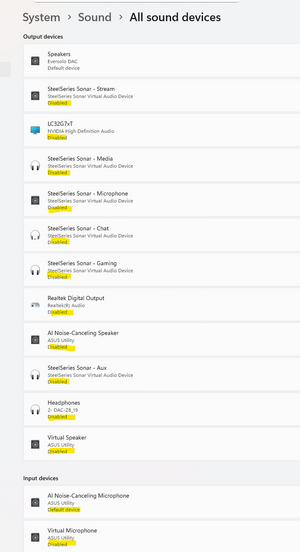

If you have more than one set up drivers showing on Windows System Sound setup, it will give you the option to disable.
If other drivers are present in addition to to the Ifi, disable those, like I have below 🙂

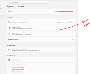

If you then scroll down, you'll see All Sound Devices - click here
This will allow you the option to disable the other sound drivers - I use my DAC, so there's no need to use other software.
If the problem, still persists - click on to MS support as highlighted in yellow 🙂 This takes you to MS website for further support.
