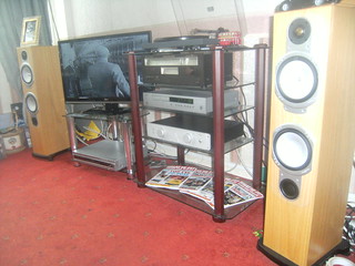

really need a dedicated hi-fi rack. So much better than sofas or armchairs. They can be picked up dirt cheap - this is similar to mine
