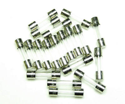

Have you checked the 'secret' fuse on your Naim?
If not, with the mains connector removed from the back panel, open up the fuse compartment immediately to the right of the connector. A small, flat-bladed screwdriver will do it.
You might be able to see whether it's blown (a meter would confirm it).
With a bit of Christmas luck, £2.50 will soon have your amp back in action (and give you 9 spare fuses):
If it works, I'll accept 50 of the 300 quids you were about to waste 🤑

Hi I've checked everything replaced the fuse in the plug and the secret fuse and still nothing
