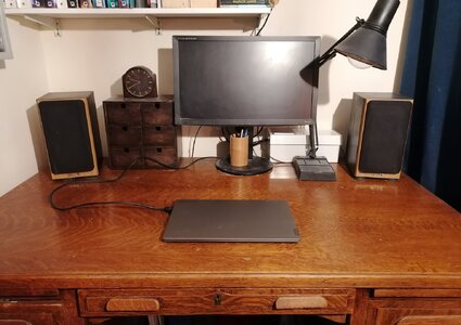

I will be changing the speakers in my main system soon, and thinking of moving my current speakers - Tannoy Mercury M1 - into my bedroom. They are rear ported and not as forgiving over positioning as the Missions I currently use, but their diminutive size makes them better suited to the location.

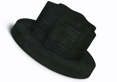

My only experience is the Q Acoustic speakers I have in my AV system came with foam bungs for when they are placed next to a wall. As rear and side speakers they aren't doing that much work and I can't tell the difference.
Before I start experimenting, has anyone tried stuffing something into the rear port? What did you use, foam bungs, or some sort of cloth?

Quite a few bungs don't stay in the ports due to the sheer velocity of airflow - I find placing the bung in sideways helps it stay in, and doesn't slow the airflow fully, which many do. Fully bunging a speaker that's designed to work as a ported speaker usually sucks the life out of it and destroys the intended balance - some speakers deal with this better than others.

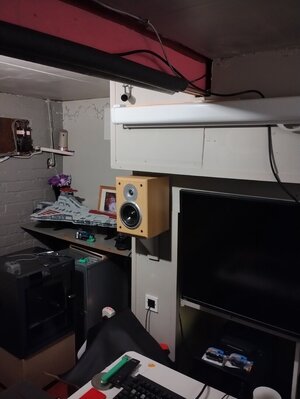

The speakers in my son's system are in the worst possible position. Rear ported TDL on little wooden brackets I made, fastened to the pillars in the cellar that support the chimney breast. The rear ports are about a centimetre away from the wall. I'd like to replace them with front ported speakers. We haven't even tried putting a bung in the ports.IMG_20260117_094603598_HDR.jpg

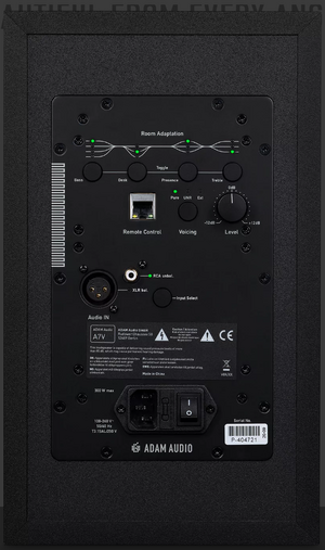

It's nice to see professional outfit Genelec move into the domestic scene. Hedd and Adam studio monitors who also have their own bespoke calibration software, don't seem to have the same appetite for the residential markets, maybe it's only a matter of time, they do the same.

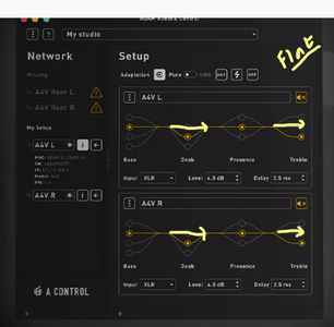

I got the calibration set to neutral (flat line) on both my Adam AV7 speakers, never felt the need to explore this further but if I decide to move my kit to the other room, I might start tinkering around with it, only because I'm curious 🙂
If you have it wired to the internet, you can adjust the room adaptation remotely.
