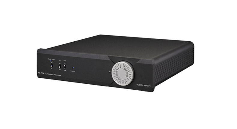

Does this mean that the Musical Fidelity mx vynl recommended by whathifi mag is not up to it or is faulty as that is not the case,when for instance I have it connected to a hana ml or an Ortofon 2m Black.With the Hana I definitely have to increase the volume .
Perhaps it's a Gain issue with that mx vinyl.
if it can amplify that Ortofon to a 2v line output then it should be able to do the same with the Hana

That EQ switch needs to be set to RIAA.
Perhaps you need a phono preamp that offers more when it comes to low output MC cartridges, I didn't realise it was that basic.
RIAA seems to make no difference at all.

I've set it to 100ohm as per hana manual and numerous recommendations from other users of hana ml

  • The maximum MC gain of 63dB is barely sufficient for very low output MC cartridges of 0.2mV like my Lentek Entre. The additional 6dB provided by the balanced output is not relevant to most systems as many inputs will drop the balanced level by -6dB in order to match other unbalanced inputs.
  • Low end cheap external switched mode power supply (12VDC @ 500mA).
  • The single rail input voltage from the switched mode power supply is converted internally to dual rail using a DC to DC converter – basically another switched mode supply. The good news here is that it is so well designed it creates little to no noise. This one feature almost caused me to not buy this pre-amp as I intensley dislike all forms of switch mode power supplies, particularly when used in low level signal amplifiers. (Linear power supplies rule the roost here)
The Gain​
  • MM Gain – 42dB or x125 – max gain 48dB or x250
  • MC Gain – 57dB or x707 – max gain 63dB or x1414
The MM figure is quiet acceptable, but the MC figure is too low for very low output (0.2mV) MC cartridges – see comments. "
That said your Hana ML outputs slightly more than the reviewers cartridge but this is why you may need to adjust your volume control so much.
