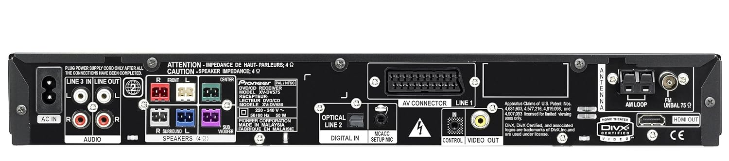

Did you look at this ? This is a DCS 370. My looks like this

hybridauth_Facebook_855065631234157 said:
What. Where?
Apologies i was looking at the wrong picture, you mentioned getting a DAC earlier on in the thread that might be the best way.
tv optical out --> DAC --> red and white phono in on your amp. *good*
jjbomber
OK I was looking at the model that BigBoss was showing. On what you have, the short answer is that you cannot input surround sound from the TV to your DCS 370.
The best you can do is analogue output from the TV to your system. Connect the Red and White OUTPUT from the TV to the Line 2 INPUT on the DCS 370. That will give you stereo sound to your front speakers only.
