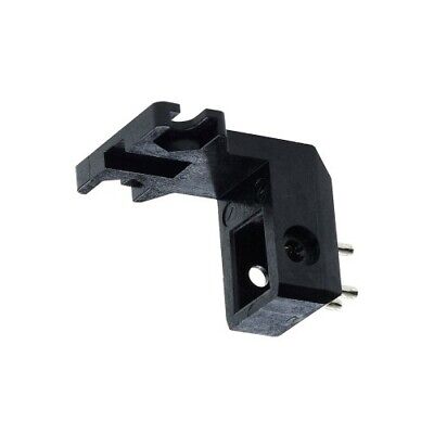

He probably has the best that is currently available already fitted....
Reactions: Dave B
As far as I can see, this fits onto a P-Mount arm, to be able to use a 1/2 inch (normal) cartridge.
tbh, I don’t think there would be many people wanting to do the other way round.
I may be wrong on this though. It’s not something I’ve ever done.

Thanks but does this not adapt a non-p mount tone arm to a p mount cartridge not the other way around unless I misunderstand?
You are correct ! These adapters are for mounting a P-Mount cartridge to 1/2 inch turntable only.... If you can find one, a good solution is to find an Ortofon OMP cartridge, as you can mount the needles from the OM series ( OMP 5, 10,20, 40 )

this should do it.
good spot, never seen one of those. However I wouldn't want to hang a heavy cartridge off this four spindly connections.....
EDIT,
No, ignore me.
that's going the wrong way as I stated before
The OP would need a 1/2 inch to P-Mount
