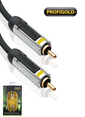

While a composite video cable is a single cable like this:

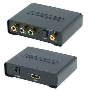

The only way round it, if you're outputting component from the Virgin box and you want to keep that cable you've bought is to use one of these between the V box and the receiver, which will convert component video and a digital audio feed from the Virgin box into an HDMI output you can then connect into the receiver.

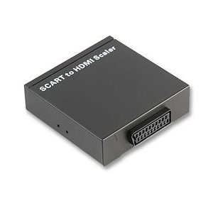

Or – and this is the simplest one of all – ditch that Scart-to-phono cable you've bought, and use a Scart-to-HDMI scaler/converter such as this:
