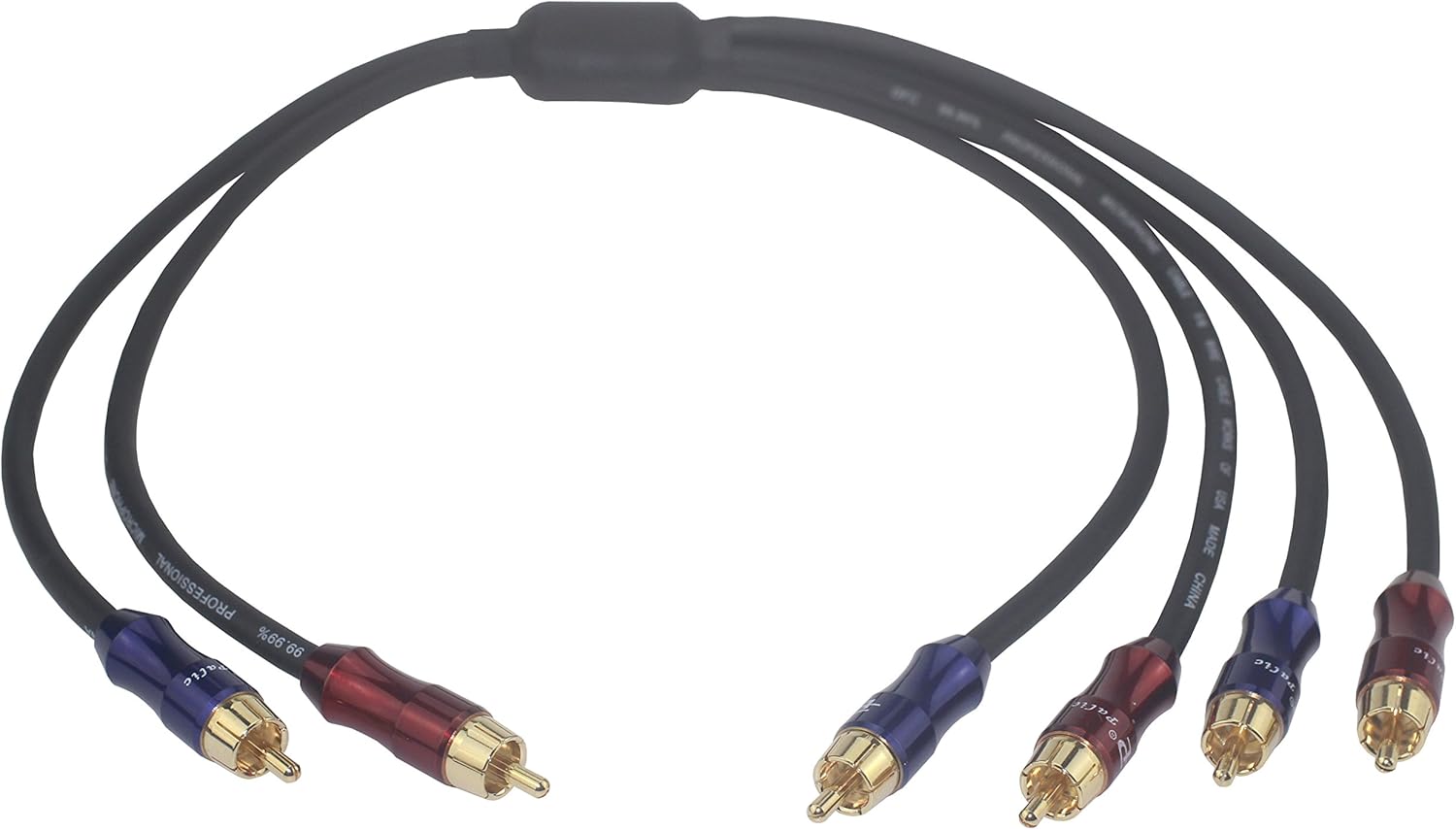

You can't do both since there no signal going into the nad amp it's going out of the nad amp pre out and into the kenwood amp with a normal standard rca cable, you need dual cable and a adapter to use 2 pair of cable from the pre out on the nad or a dual (4) to both main in and 1 pair (2) for the nad amp
Something like this
Why do you wanna use the nad 3020i as a preamp, if you know nad you would know there preamp section of many nad amps incl nad 3020a,3020b,3020e,3020i is there weakest link
Thanks, Gasolin. Today I went out and bought a set of cables similar to those you posted above. Convertion, too, to 110 v, has been a simple task. (I didn't know there's a fifth rubber foot inside the case, fixed with glue under the transformer.) As for the question about what I'll run as a pre amp, I still don't know the answer. Think I'll take my time trying some different matchings, on the next days. Surely I'm quite impressed with the sound of the Nad3020i. Maybe the best I have here.
