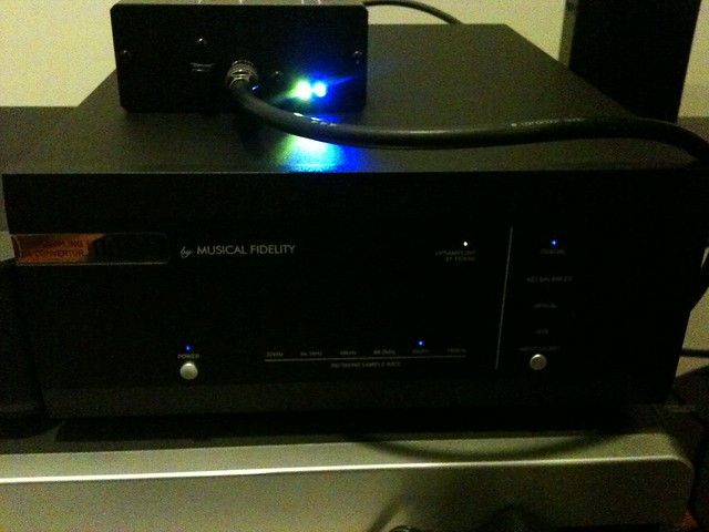

So, MF distributor offered me to review this unit as it has just arrived in his stock 2 weeks back. Yes, the unit is actually on the market for a while now but just officially brought into Malaysia.
So what does it do? It basically offer a solution for those USB 48kHz/16 bit limited bandwidth input on any existing DAC, including my M1 DAC.
Its commercial name: 24 BIT 96 kHz ASYCHRONOUS USB TO S/PDIF CONVERTER WITH COAX AND OPTICAL OUTPUT :)
Connect the unit to yr PC/laptop USB port (using A/B USB cable), it then upsamples it to 96kHz and feed this signal constantly to your DAC via optical or coaxial. Just as long as your DAC coax or optical can receive 96kHz signal and above, you are good to go.
My M1 DAC detects the 96kHz easily as shown in the picture. Then the DAC upsamples it further to 192kHz. Not sure whether this repetitive upsampling is actually good or not. Hehehehe.

As it comes under MF's V series, the built is as expected to be lightweight, mainly to make it affordable. But nothing to complain about. It is however bigger in size than I expected. Light but sturdy with all the connections to be solidly placed and does not wiggle when you try to push in that coax cable in. You have to push your coax cable all the way in before it can output the signal.
The 'Lock' and 'Power' LED however is a tad too bright as you can see above in comparison the M1 DAC LEDs.

That is actually one of the questions in my mind. Does the V-Link upsamples or not.
My MP3 files (48 kHz, 320 mbps) but as it goes through the Vlink and fed into M1 DAC, the DAC shows 96 kHz coming in from the VLink. So I was under the impression that the VLink is upsampling the digital file.

This is the thing that is still mind boggling to me. As mentione in my review, I am not a hardcore PC based audio guy, hence I am just an iTunes user which I dont think outputs 96kHz data and my laptop is a 2008 unit with Windows Vista which has a standard soundcard that comes along with the Asus laptop.
So, I think my laptop only churns out the native file itself which is 48kHz via the USB to the VLink. But the M1 DAC shows that the output from Vlink is 96kHz.
And when my laptop is connected directly to M1 DAC via USB, it only shows 48 kHz.
So, where does the upsampling to 96kHz happens if its not the Vlink? Puzzling it is to me whom is quite an IT illiterate.
