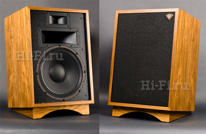

All very true, just avoid 'difficult', low sensitivity speakers and silly volumes and you will be fine.
On the other hand, a pair of these on the end of your 610 will make your party go with a bang.
