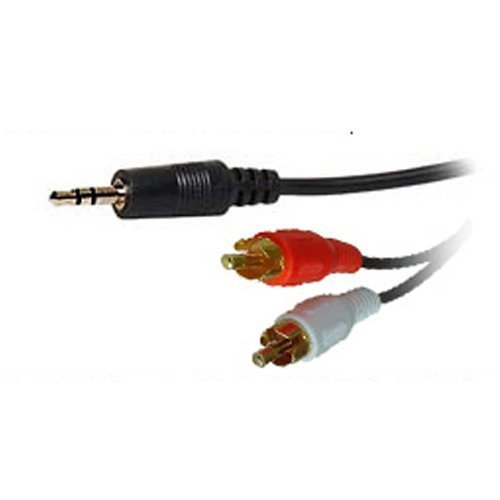

Use a stereo RCA phono --> 3.5mm jack lead from 'cheap Bluetooth Receiver and connect it to your M-CR610 (in Analog In 1 or 2) with stereo RCA phono --> 3.5mm jack lead and pair it with your tablet (or PC if that has Bluetooth as well).

I'm sorry, forgot to mention that I have a Samsung tablet. I tried to connect it with the Marantz with the USB A-micro USB cable but that didn't work.
I've ordered a stereo RCA phono -> 3.5mm jack lead as you mentioned.
