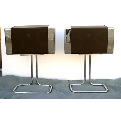

chebby said:
Gale GS 401
They look awesome with those stands.
