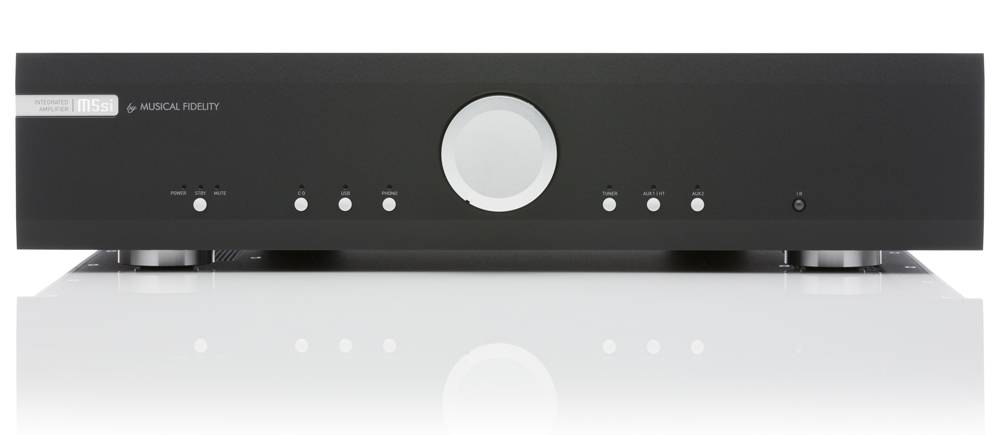

Personally id be looking at a musical fidelity cheaper than hegal especially if you're buying new
you can buy with or without the dac.
