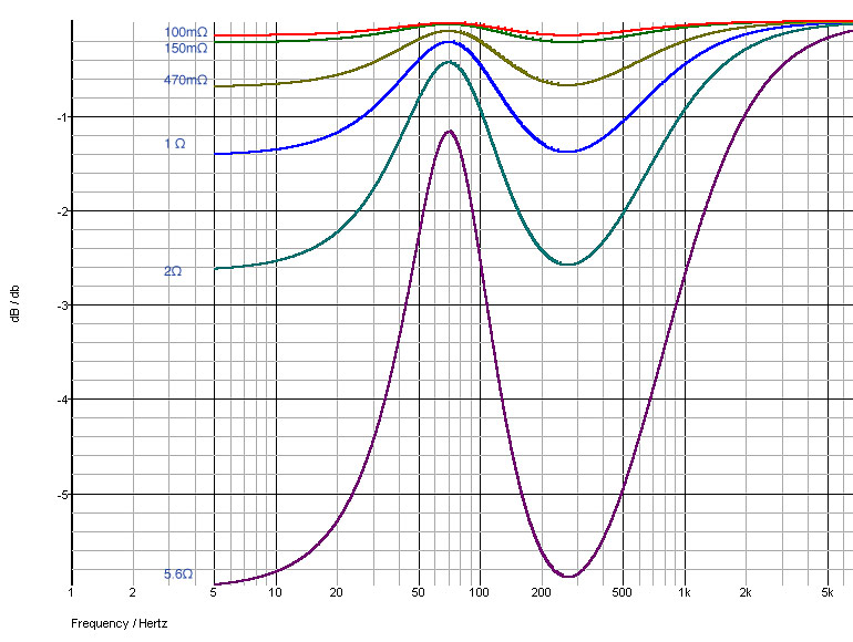

The basic premise here is playing with the gauge to hit some (slight) variation in impedance vs frequency interaction between speaker, cable and amp. What I desire is tight bass, but less of it, hoping to hear less room excitement at 70Hz (one speaker is near corner). Room height is 8ft, a curse. The speakers are well behaved but the room is being a *****.
I already got significan't improvement by raising the speakers few inches on 3 layers of marble slabs. I changed speaker gaskets to get better air seal, that improved things a pinch. Decided to try this cable gauge thing, but I have nothing under 12 AWG that's not oxidized CCA (Copper Clad Aluminium rubbish). So I ordered new ones.
According to Audioholics with 16 AWG on current hungry 4 ohm speakers I'll be edging the adequate, which is my intention. With 22 gauge lamp cord I got harmonica bass lmao... so terrible. I'm hoping 16 AWG won't do that or be shrill in the lower highs. I can live with rolled off top end since I hear nothing beyond 14.5kHz.

Conductor resistance 16 Ω/km = 0.016 Ω/m, so 0.032 Ω per side. Hmmm... we shall see (hear).

insider9 said:
Trying to remove a room mode with a cable will only work if it's large, really thick, carefully positioned and made from fiberglass ;)
Unfortunately I can't use a bass trap in that corner.

Slight EQ perhaps. It's likely to affect everything up to 300 or so Hz but may be worth it. Do you know which dimension is causing the mode?
You'd need to be really lucky to have speaker impedance curve extreme at 70 Hz and then perhaps you may see some results with a different cable. Anyway at the price paid not really an issue :) and will be happy to read results achieved.
In a frequency sweep at 70Hz-80Hz I get major boom in that one corner. Bass guitar notes hit it hard. Everything else isn't objectonable to my ears. Using the tone controls helps a bit, but the bass tone attenuates 100Hz and treble 10kHz, so not perfect.
I'm not saying a cable will solve it, but after trying a myriad of things some have brought improvements. I'm going for cummulative results. If no improvement, no big loss really, I get an extra usable cable for smaller speakers which I paid 7 quid delivered.
