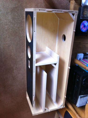

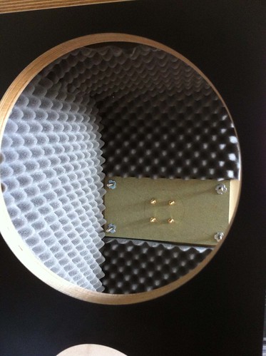

internals of one of the speakers.

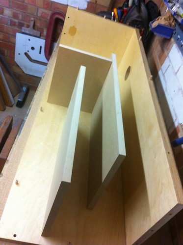

cabinets in workshop - 24mm birch ply with black lam front baffle
PAF foam in cabinet internals
internal panels
glueing up cabinets

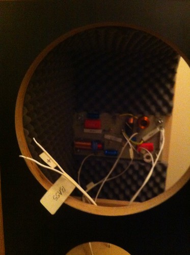

crossover board viewed thro bass driver cutout

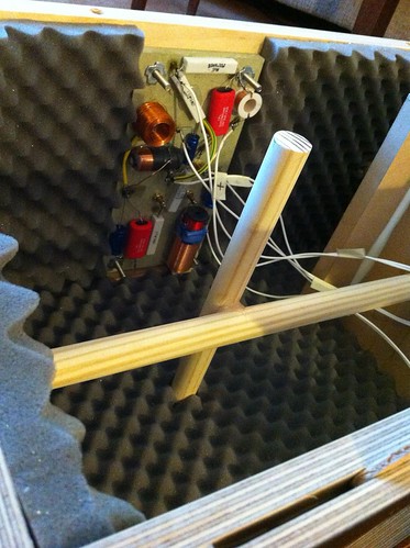

crossover and bracing to stop panels ringing

The kit consisted of the following
2 x bass drivers 10"
2 x mid drivers 5"
2 x ribbon tweeters
Crossover components
Fixing screws / bolts
Profiles acoustic foam
Long haired wool for internal damping
Internal wire for connections
I made the cabinets from the plans provided with the kit. They are made from 24mm birch faced ply with 18mm mdf internal baffles finished externally with 20% AC lacquer. The front panel is 24mm birch ply laminated with FA Black laminate.

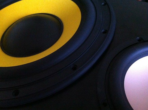

view of drivers

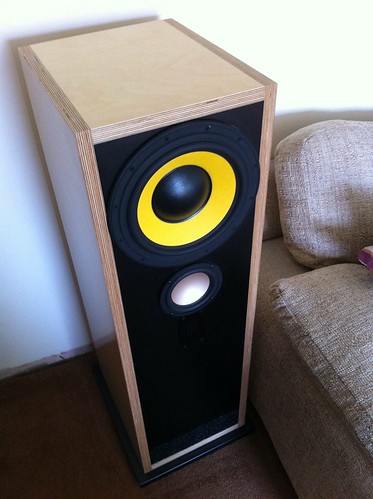

view of finished speaker

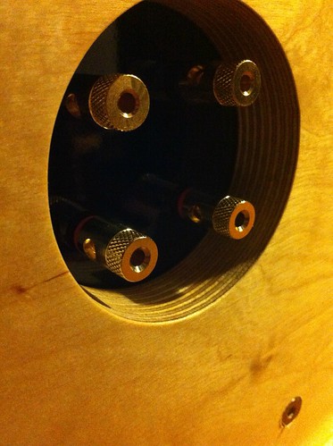

connection panel on rear
The finished speakers sound excellent. Previously I had been using monitor audio s8’s and there is just no comparison. Unbelievable as the kit cost half the price of the MA’s.
