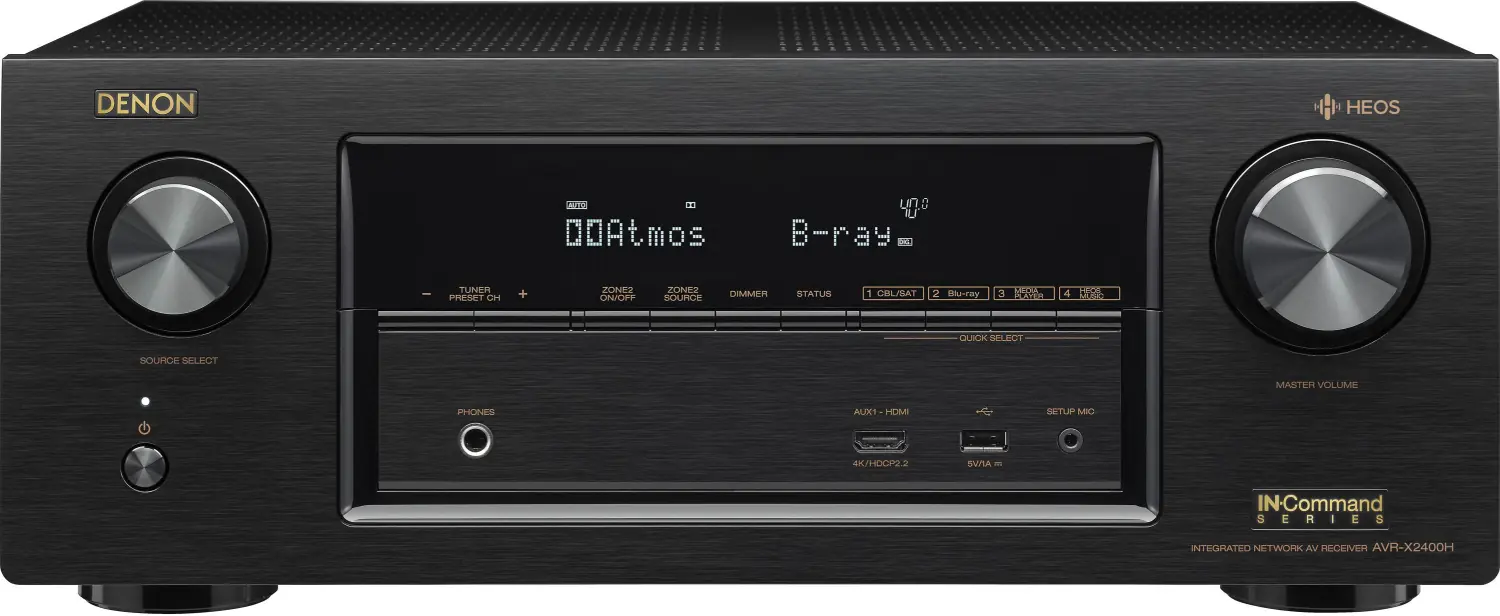

Well am I missing something? I can find Denon x2400h cheaper than x1600h. Is x2600h superior in some aspects? Should I go with the newer released version?
Thanks,
Niladri.
X2400H is the older model while X2600H and X1600H are newer models. In terms of pure performance, X2400H will be superior to the X1600H (although whether there will be a discernible difference, one can only tell by a direct comparison via demo).
Difference between X2400H and X2600H here:
It's going to be difficult for me to suggest subwoofers as I haven't demoed the subwoofer brands you mention. But going by the reviews, BIC Acoustech and Polk Audio subwoofers seem popular. See if you can afford and accommodate a 12-inch subwoofer ideally. Otherwise look at 10-inch and 8-inch models (bigger the better).
Speakers, depends on your budget really. I would suggest you check the AVR and subwoofer with your existing speakers. A very good subwoofer can negate the need to upgrade your speakers.
