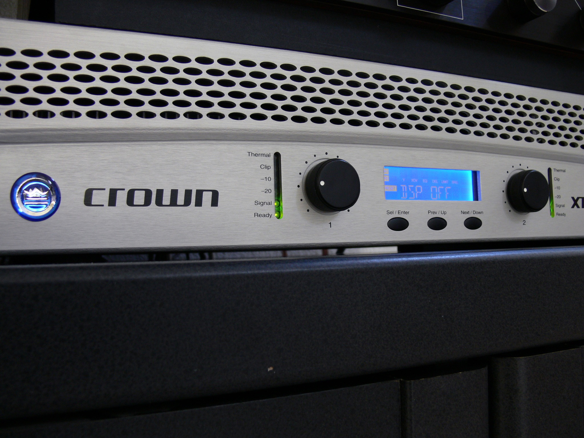

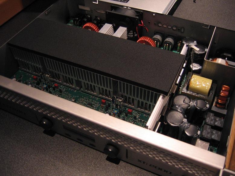

I personally like the looks of the XTI 2000. 🙂
Can't comment on that model. The XLS 602 and 802 I liked. Most importantly no annoying hum and hiss.
