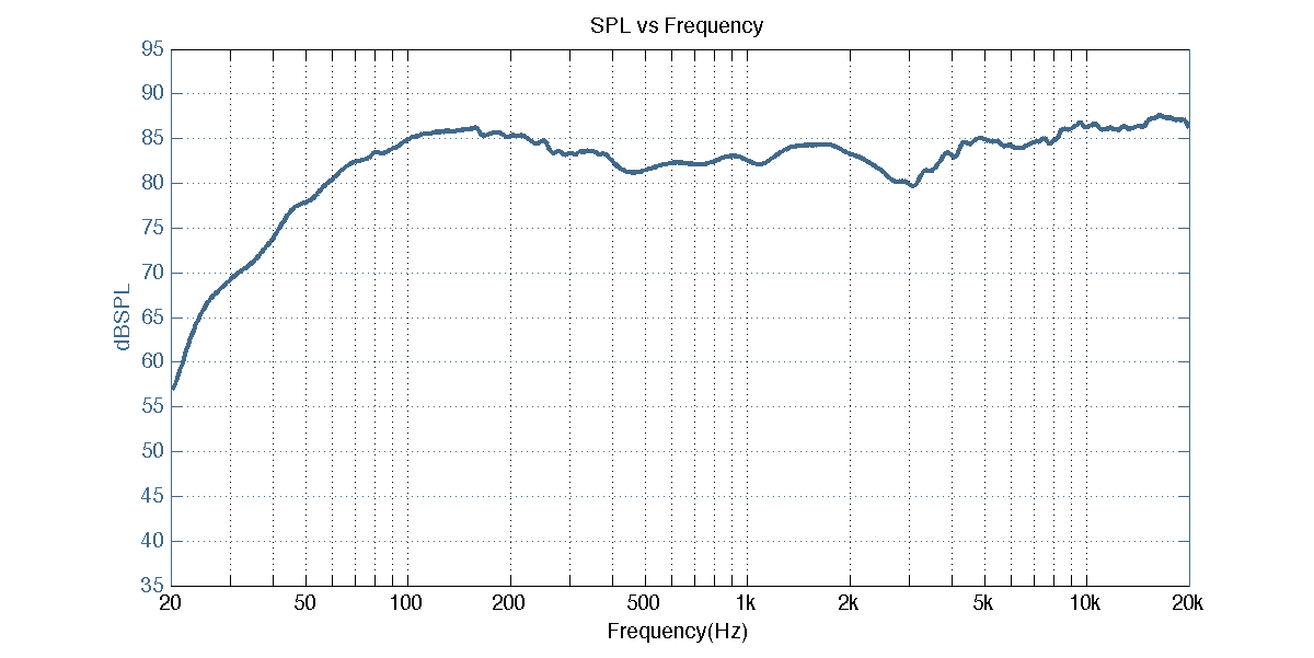

If anyone's measuring the volume using a app on their phone it's usually pretty pointless. Unless you have a proper calibrated microphone then you might as well just guess what SPL you are listening at.
