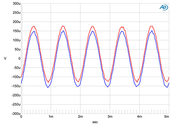

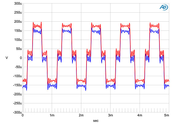

see below graphical representation of 1kHz sinewave recorded at -90dB referenced to full scale. this is only 6dB above resolution limit for 16 bit format and some 50dB above resolution limit for 24 bit format. first quantized with 16 bit data:
and now quantized with 24 bit data:
as you can clearly see both graphs look markedly different. the reason is higher number of amplitude "steps" that 24 bit format can carry and therefore it can reproduce infinitely variable analog wave more faithfully. -90dB input signal is somewhat extreme but it proves my point. BTW this example also shows that using any digital format to its limit is pointles.
if you were comparing the same sine wave recorded at full scale you'd see no difference between 16 bit graph and 24 bit graph since +65k amplitude levels for 16 bit audio is more than any human can discern between.
