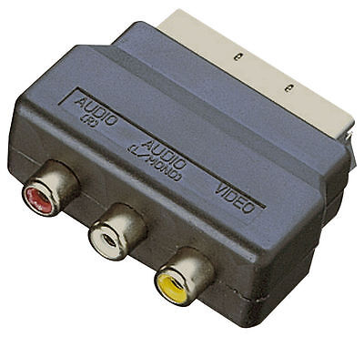

Set your turntable's switch to 'equalizer on'
Buy this and plug it in the (top) 'VCR Input' on your hi-fi:
Ignore its yellow socket. Connect your red and white turntable plugs to it.![]()
RGB SCART Plug Male to 3 RCA Female A/V Adaptor Converter for TV DVD VCRs 5055393689856 | eBay
Find many great new & used options and get the best deals for RGB SCART Plug Male to 3 RCA Female A/V Adaptor Converter for TV DVD VCRs at the best online prices at eBay! Free delivery for many products!www.ebay.co.uk
From then on 'VCR' on your source selector will be your turntable (so you might want to re-label it).
Any problems, get back here.
Otherwise, enjoy your vinyl.

Great, nice to think £2.49 might do the trick - I will say this though Daisie.found switch and scart on order will let you know what happens ,thanks for your imput.

That's great news Daisie (or Dave as you signed off aboveGray the item you gave me info on works a treat thankyou so much just need to research a new turntable .
