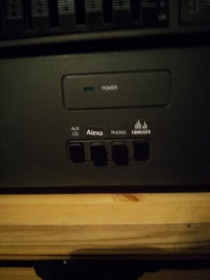

I have a little blue tooth label printer I used with my phone will see what I can make for labels after me dinner than you once again
Alexa lable replacing tuner might not be straight but after 9 bottles of brown ale and two flaming sambooka as straight as I could get it. May reposition tommorow when sobar.1000000382.jpg
