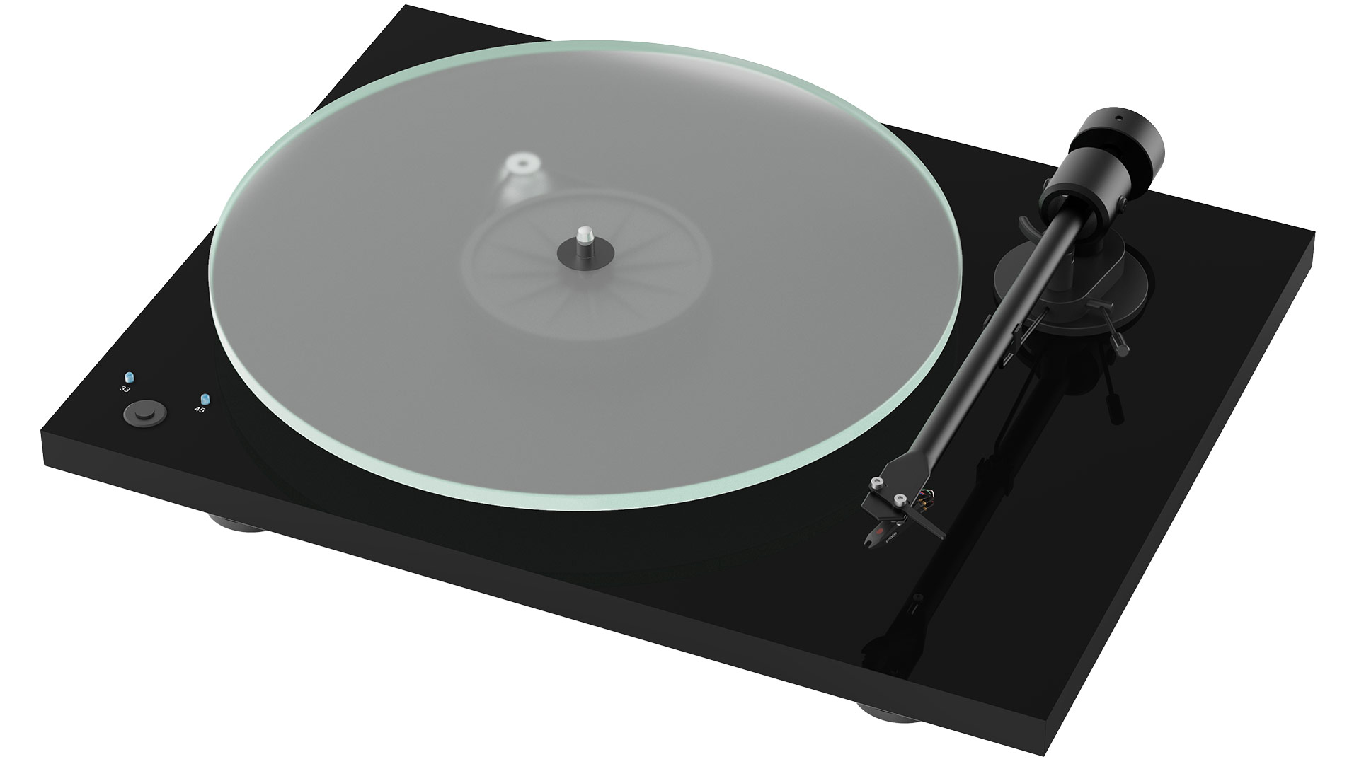

Complete novice here. We've gone from a plug n play vinyl player with everything built in (£69 hmv special) to a full new setup after deciding we liked vinyl again and spent over £3k on vinyl in the last year. We had some recommendations and went for:
Pro-Ject T1 Phono SB Turntable
NAD d3020v2 Amplifier
Kanto YU6 Speakers
However we are having some issues connecting everything and we have no sound. The manuals are more than useless and we've got nothing to follow to connect all 3 together and now we are debating whether they are compatible, the need for a pre amp etc?
Is there a full guide anywhere? Tried watching loads of various youtube videos but cant seem to find anything.

You seem to have bought active/powered speakers when you really want some passive speakers to connect to the Nad amplifier.
I agree. It’s a bit like buying two engines, plus a motorbike and wondering why you don’t have a car!
To Peter: I’m not making fun, honestly, but this is why you should go to a shop for advice. Picking stuff online isn’t how to buy a system - I’m guessing that’s what you did.
You also have two phono amplifier stages - one in the SB version of your turntable, PLUS one in the NAD amplifier (it was added in the mark 2 version). But you only need one.
Can you return the speakers and turntable and start again? The amp is fine, unless you really wanted an all in one system of some sort. Or return everything then pay a visit to Richer Sounds who’ll get you sorted properly?
I would agree, even if you could link all that together you would have a sad affair to play decent vinyl through, sad to say.
Reactions: aversaurus
Don't need the amp as the turntable will connect to the line-in on the speakers. There is a phono switch on the turntable as well as another on the speakers. Make sure they are both set to the same thing, i.e. both to Line or both to Phono.
Actually, one needs to be phono and the other line, surely?
I’d not appreciated that even the speakers have a phono stage - so, yes, no NAD amp needed. Three phono stages in one system - that’s surely a record?! (Pun intended). :p

You don't need a ground cable from the turntable because it already is, grounded that is
Here's a quote from the owner's manual regarding the RCA connections & Earth ground to the Pro-Ject T1 Phono SB Turntable:
"Take care to connect the left and right channels correctly. The right channel is usually marked red, the
left channel black or white. The earthing wire of the tonearm lead should be connected to the earth
terminal on your amplifier (if provided)."
Photo 1 shows the Earth ground location on the turntable.
Additionally, the NAD integrated amplifier clearly has a Earth ground terminal as well.
Photo 2 shows the Earth ground terminal location on the amplifier.
