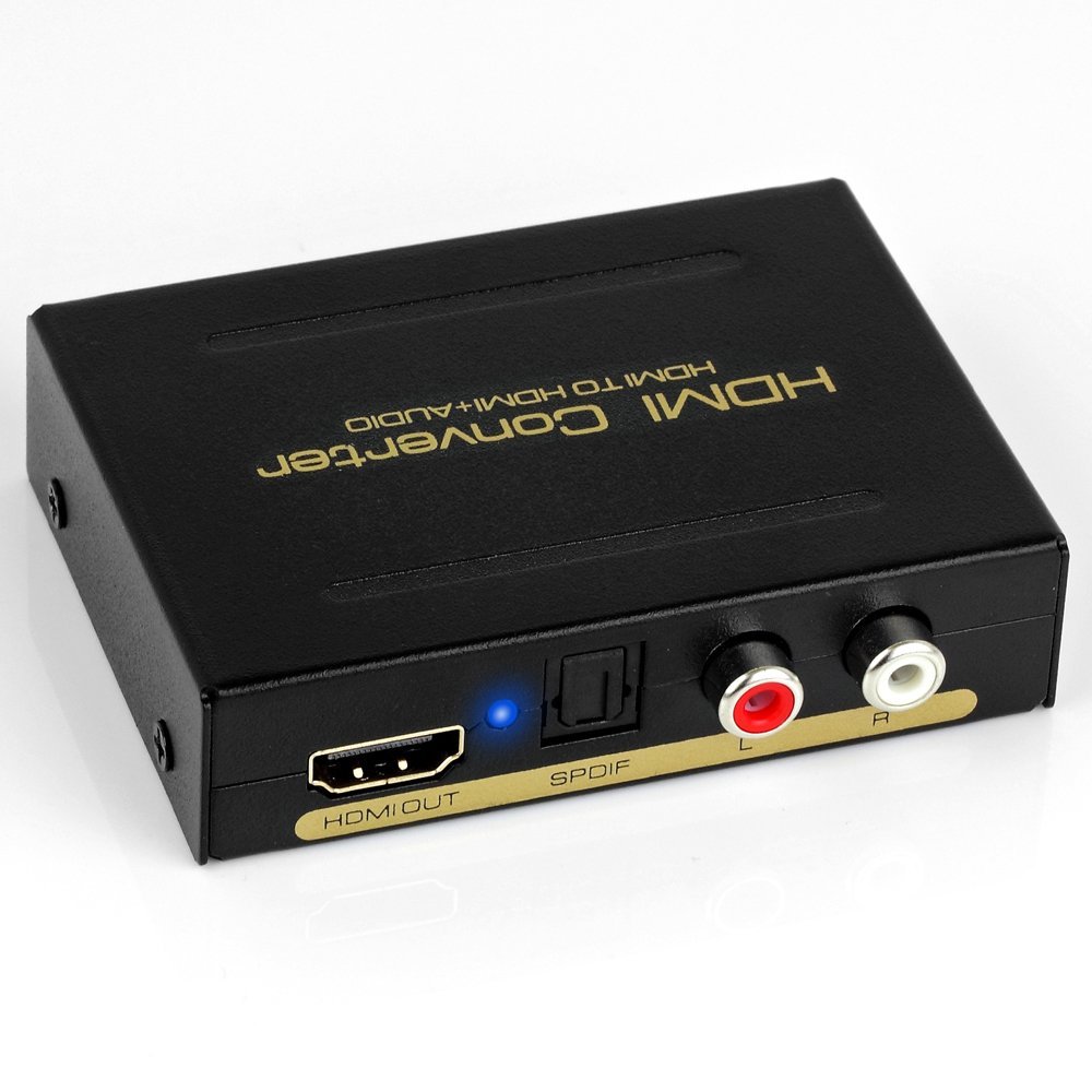

You could use something like this, which will split out stereo analogue audio from the HDMI connection between the PS4 and the TV. You can then connect its L/R audio outputs to an input on your amp.

spiny norman
Jan 14, 2009
293
LonsdaleMBM said:
Hi all, thanks for your help to date. I've checked and it appears that my tv has compenent in but not component out. On that basis, should I be buying a toslink DAC?
Unless the TV also has a digital audio output, no.
