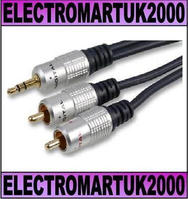

You would connect from your NAD tape outs to the Bluesound analogue input using a lead like this:
The NAD's front panel rec selector would then determine which source goes out to the Bluesound (Which can be the same or different to your main room listening).

I wasn’t sure about the Bluesound Node 2i (as I am more familiar with Sonos) but the product page seems to confirm that it does take an analogue input
Featuring an array of analog and digital input and output options, the NODE 2i gives you infinite playback choices to rule your sonic domain. With the ability to connect to a CD player or turntable, the NODE 2i ensures that your physical music collection continues to thrive. Easily stream your favorite tracks from the source of your choice and hear it anywhere in the home.
Audio Input
Combo - TOSLINK / 3.5mm
So you’d use an rca to 3.5mm cable.
