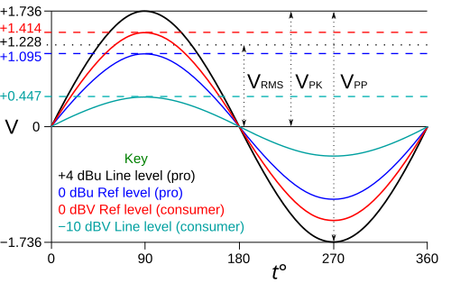

To reinforce Dave's point, the impedances are fine, it is possible that the combo might be a little quieter for the same setting.
The truth is that the specs for line level are a mess, it is unclear what 'nominal' means for Arcam or what the input level means for the Exposure amp - peak? RMS for full power output? could mean anything to be honest.

The specs are pretty inconclusive, the Exposure power amp would seem to take a little more driving than the Arcam but I doubt the differences would be that great in practice.
