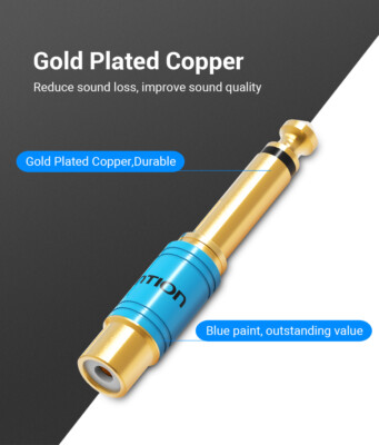

Hey, did you buy the headphone amp. I was thinking for the same setup. How did to plan to connect the balanced TRS output of ID4 MkII to RCA (unbalanced). I am confused on this only, I am unable to find a balanced TRS to RCA connector in my country. Can you tell about the cable that you are using for connecting amp to audio interface?
Does balanced TRS to RCA even exist? Don't see how this would or what benefits it might have. Balanced TRS is to connect a pair of headphones as far as I am aware.
If you need to connect to something else there is an unbalanced headphone output socket isn't there?

"How did to plan to connect the balanced TRS output of ID4 MkII to RCA (unbalanced)."
that's not how I read it......
Yes, he thought it was balanced out.
I thought I saw that it was balanced out - as it is on other interfaces.
But, as Vincent pointed out, in this case they're using a single TRS socket to output 2 (unbalanced) channels - saving themselves a socket in the process.

Hi, I might be wrong but in the official manual provided by Audient, it is mentioned that the ports at the back are TRS balanced port. Attaching a screenshot and link of the manual for the same (page 9 of the pdf).screenshot_audient.png

Hi, I might be wrong but in the official manual provided by Audient, it is mentioned that the ports at the back are TRS balanced port. Attaching a screenshot and link of the manual for the same (page 9 of the pdf).View attachment 3476
That linked manual is the one I saw 👍
Very much describes the DAC output as a balanced TRS......no mention of both channels (there at least) on a single socket 🤔
The 'Loudspeaker Outputs' are balanced TRS.
The company is certainly ambiguous with its descriptions.
OK, we know there are no actual loudspeaker outputs, but not every purchaser would.

I've not looked at the manual but, the specification I linked to earlier, clearly states there is a ¼ inch trs line output, trs cannot be balanced. It makes me wonder if, whoever was responsible for the manual and the online spec sheet, got a bit confused...
