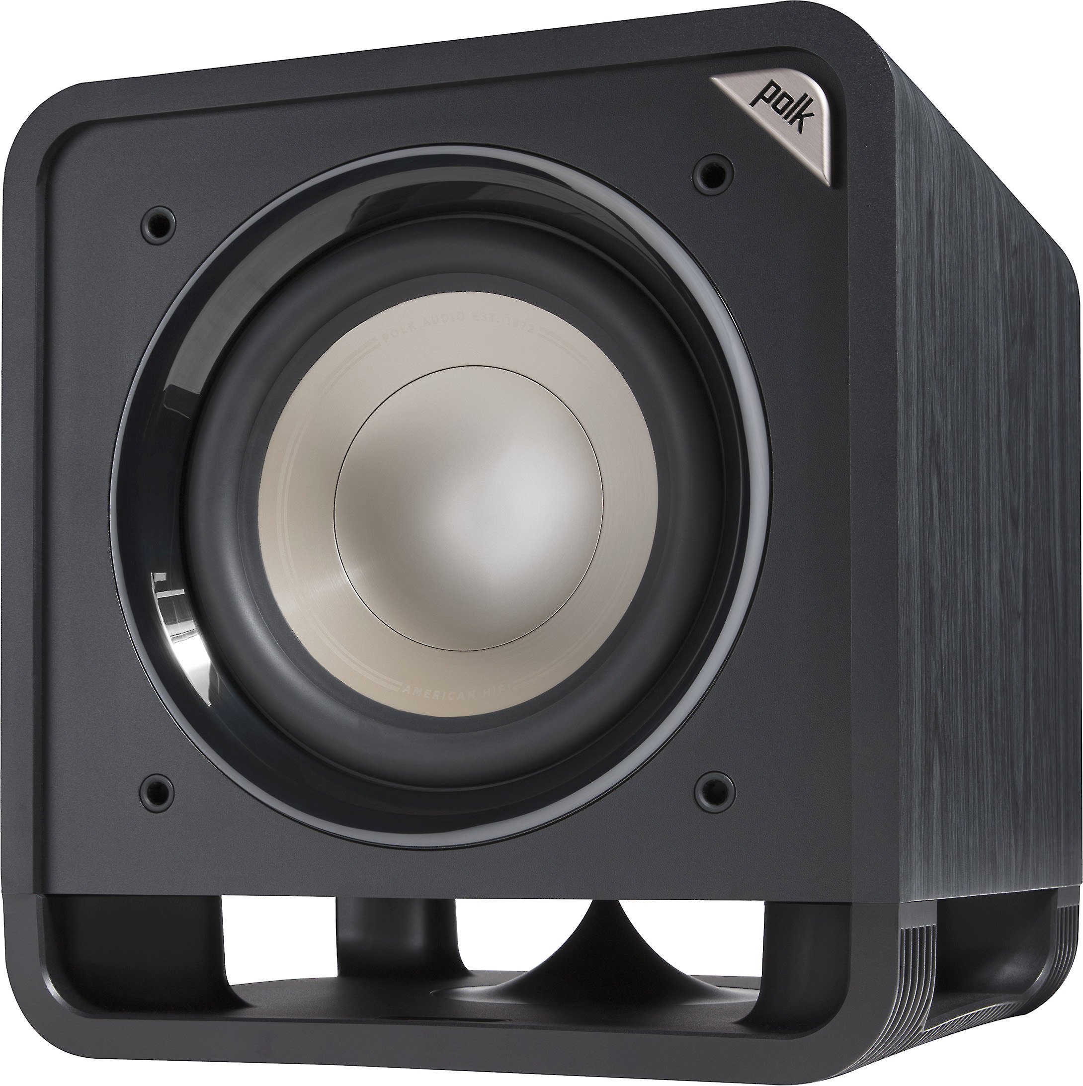

2. How about if I want to connect a sub with no Outputs like this one?
www.crutchfield.com
Polk Audio HTS 10 (Washed Black Walnut) Powered subwoofer at Crutchfield
FREE 2-day Shipping: Powerful bass from a customer favorite Polk Audio has been one of Crutchfield's best-selling home speaker brands for decades. And for
www.crutchfield.com
www.crutchfield.com
In this case can i use a Y splitter from TV out to connect to both speakers and my subwoofer inputs?
