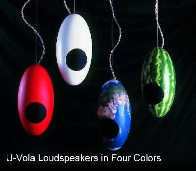

However, yes, it can be done, though I'm not sure whether these ever took off:
