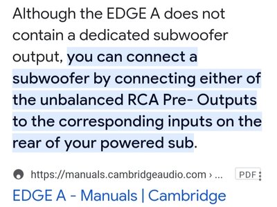

Please advice how is better to connect subwoofer to my amp with two speakers - obvious option is biwiring where LF goes over sub, but some people say that is possible to use amp's pre out RCA(there no LFE out on amp back)

Well that's an assumption. I set up an Edge A with whatever the stereo power amplifier of the range is for a friend not long ago, as he wanted to bi-amp his speakers (don't believe in it myself, would much rather go for a more powerful single amplifier, but that's a different conversation). It works. CA wouldn't put the idea of adding a subwoofer via this method in the manual if it didn't.
