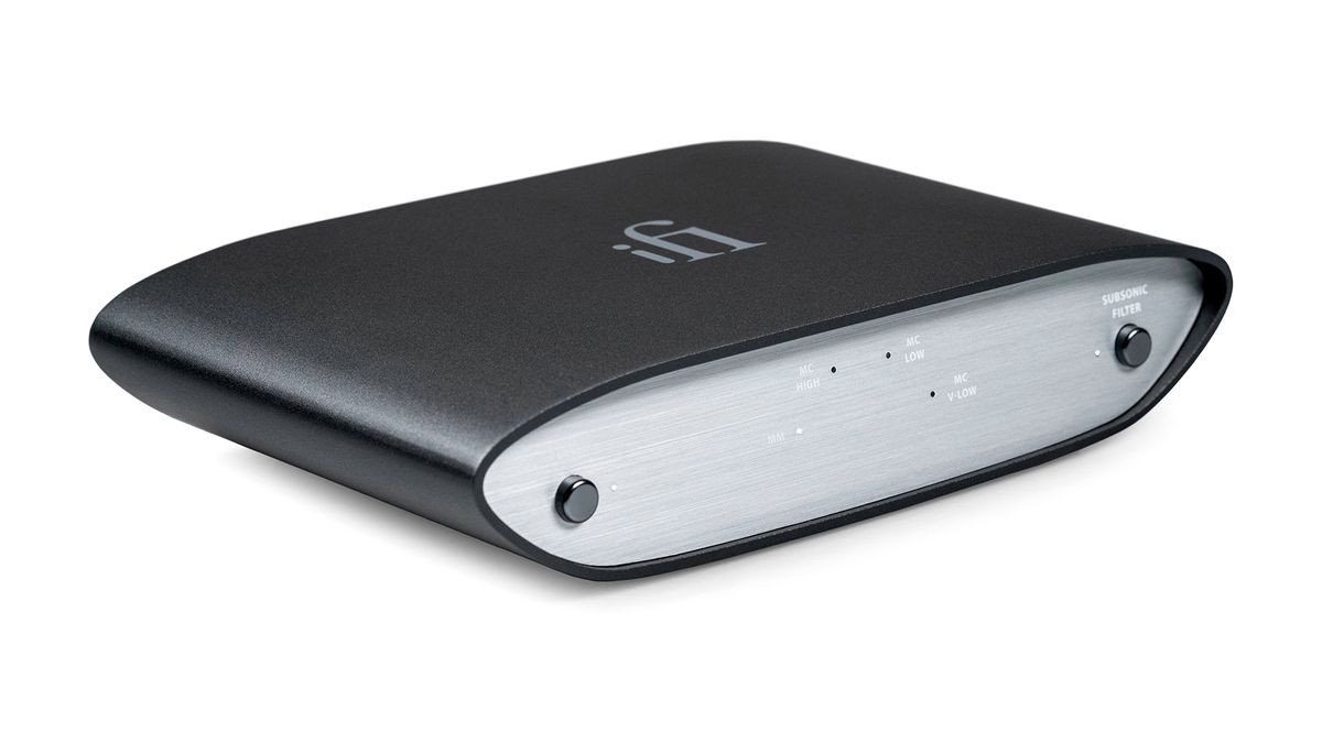

There's a good little bargain with the very well reviewed ifi zen phono which covers both MM/MC record cartridges.
It would then just be a case of hooking a Bluetooth transmitter into that.
I can vouch for ifi zen, they are very well priced and sound very good.

...or the latest version.
More money, but still only £249.....and no less than a 10 out of 10 review for what its worth here:

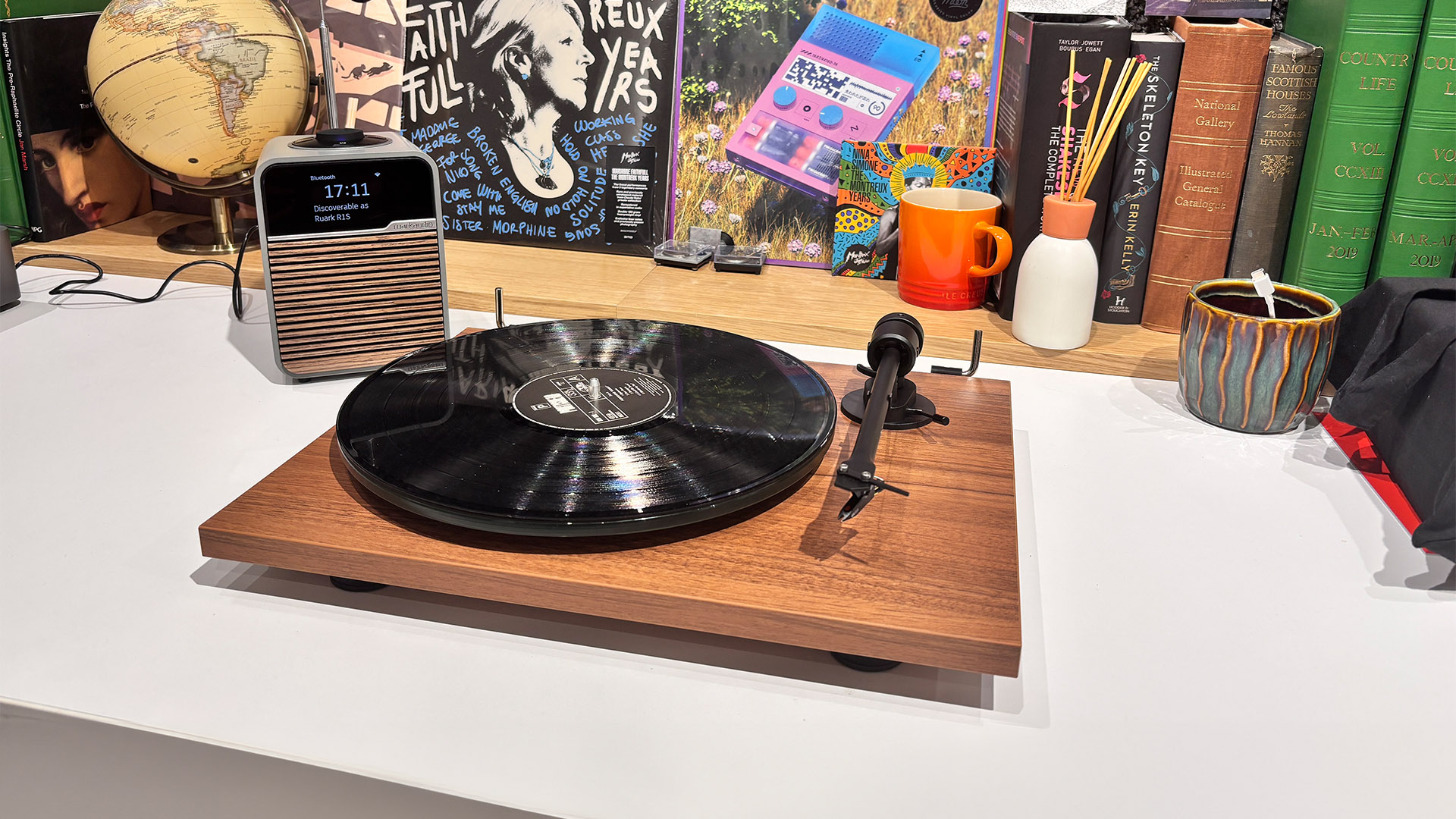

You could instead get a different deck with inbuilt BT connectivity and then use the SL1200 properly elsewhere.
Some examples here:
