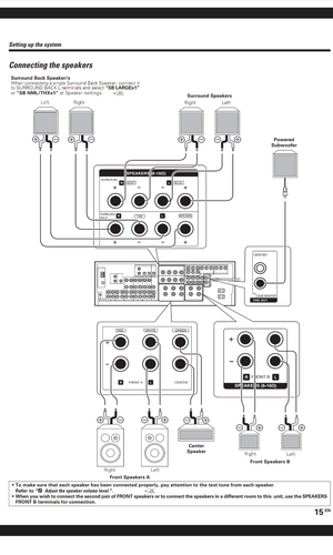

I would appreciate your help if you can offer some tips about how to connect the Re: equipment in that way:
I have already tried to connect the bottom connectors from the speakers to the front surround connectors on the amplifier, and the upper ones from the speakers to the front "A" connectors on the amplifier, but IN THE AMPLIFIER'S PURE "STEREO MODE", no signal is sent to the lower connectors on the speakers (the ones connected to the surround connectors on the amplifier).
I have discovered that by connecting only the lower connectors on the speaker, just to test if the sound reached the speakers.
The only way to get sound from the surround connectors is by activating some (for me) unwanted special effects like DSP, THX...
I want the equipment for music only.
I am attaching an schema of the rear connectors from this home cinema amplifier.
* Chatgpt advised me that schema, but, surprise... It did not work.
It also said that it was the method to-go, because the surround had another amplifier circuit distinct from the main one on the "A" speakers, and thus I would achieve biamp.
It did not recommend to use speaker b connectors from the amplifier because, it said, they were sharing the same amp circuit as those on speaker b, so no real biamp would be achieved...
Many thanks in advance,
Roger

Using any of the surround connectors is not going to work for what you are trying to do as they are for surround speakers - hence why you get sound when various surround/DSP modes are activated.
Do you have the bridging/terminal plates/bars (pick a term 😀) for the speakers? If so, make sure they are in place and simply connect your speakers to Front A on the amp. Then simply enjoy the music and give no further thought to the connection,
In theory you could use the B terminal as well but it is likely sharing the same circuit as the A terminals and is debatable whether it would bring any audible difference anyway.
You need to be sure what that Kenwood actually does in 'pure stereo' mode.
I think you're expecting it put 2 channel stereo equally to the front and a surround pair....using separate amps. Some surround amps do - but it seems yours isn't doing that.
Your user manual will (should) be specific on what pure stereo mode is on that particular model.
No good making any assumptions or doing any diagnostics unless and until you know what the thing is supposed to be doing 👍
