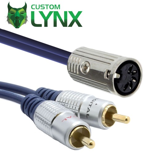

Unless it has a very rare control connection, the output is likely to be a 5-pin DIN plug, so all you need is a converter like this.
Then you can use any phono stage and/or integrated amp. I’m not sure how easy it is to get styli now, but if it’s working (once fixed) then it’s a fabulous thing. That said, perhaps not ideal outside of a complete B&O system.
What budget have you for the rest, because with a nice sized room like that you could easily spend ten grand? For a reasonable cost a Cambridge EVO 150 looks quite cool and can power any speaker.

It's a 7 pin (see picture)
Well if you intend to use it with modern day gear, here's what I'd suggest:
When you put it in for repair, ask him to replace that entire plug / cable with a twin cable with RCA plugs.
Discuss the earthing arrangement with him. (He could wire it internally so that the twin plugs are all you need...or, at your request, he could bring out a separate, single wire for you to attach to a ground post).
Ask him if he can preserve the old cable (not cut it) so you can store it.
The price those things are going for, you must retain the option of one day reverting it to original (although someone, such as yourself, might welcome the conversion.....you can charge them another £500 for that 🤑).
