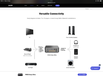

WHY the amp has peg, max and min gain when doing room correction,max Q, frequency rang i does room correction , target curves, non boost mode values set is not above 0db, smoothing main speaker output bass, subwoofer bypass mode,sync subwoofer and spakers, eq works after room cotrrection (get adayton usb mic)crossover in 1 hz incremenst from 30hz to 250 and -15 db to + 15 db, phase adjustments, volume limit lets say 90% of max power when volume is at 100% balance,stere ,mono.left or right channel,fade-in and fade-out effects somooth transitions between tracks, eliminates click and pops, you can do steret room correction or mono room correction (each speakers, takes longer time)
I don't think it's basic room correction

From the reviews I have seen- no What HiFi one yet- the Wiim Amp Ultra seems to stack up well against the Marantz, Rotel and Rega IO and I do want streaming at some point. However the main reason for getting the Wiim at the moment is that I have seen some positive things about the room correction and I am nervous about the space.
