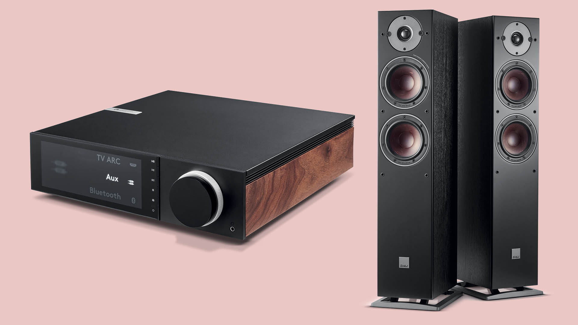

How about pairing 702 S3 with Cambridge Audio Evo 150? Seems like a much easier option.
Some says Evo 150 is capable of bi-wire.
May I know the advantages for bi-wiring?
Reactions: brightontam
Seems to be the rage - but even if you don't want the speakers, seems a cracking deal on the 150 (and somewhat cheaper than the Marantz (notwithstanding your willingness to play at that price point).
Thanks @Juzzie Wuzzie for the quick response. But I am not sure whether Evo 150 will provide the same, or even better sound quality than Model 30.
Evo seems like a good deal.
You're confusing me given you ask ... "How about pairing 702 S3 with Cambridge Audio Evo 150? Seems like a much easier option."
But the M30 at twice to three times the price of the E150 should be better.
