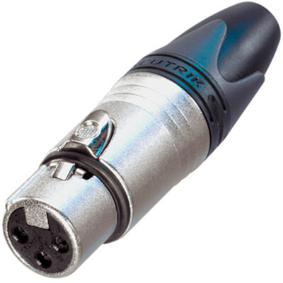

Neutrik Female XLR Audio Connector NC3FXX 3 Pin Pole Nickel Body | eBay
Neutrik NC3FXX 3 PIN Female Inline Connector. Title NC3FXX. The connector has a chuck type cord grip for great cord grip. Fits cable with aCable O.D. 3.5 - 8.0 mm. Connection Type XLR. Insertion force ≤ 20 N.www.ebay.co.uk

I wouldn't think twice about using XLR if I was in your position (Leon in post #13).

Good for you. And what better time to do it?Thanks. I'm pretty decent with a soldering iron so i might give this a try.
