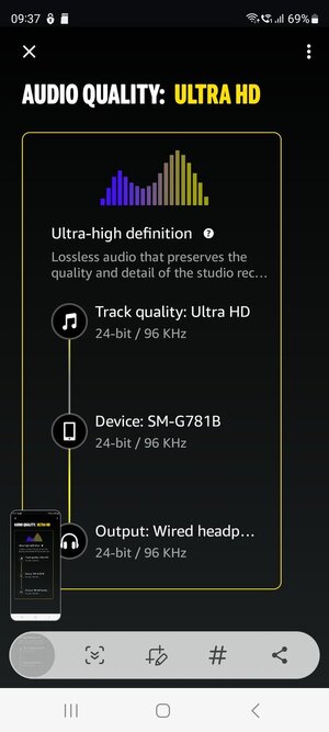

I just tried an experiment.
I played David Bowie's Lets Dance from the S20 phone to the amp via my BT connector - this one BT Connector It sounded fine. The attached screen shot shows the connection and playback data which is 24 bit 96KHz for the original source, the device, and the output.
I then disconnected the BT device and plugged an RCA to 3.5mm cable with a 3.5mm to USBC adapter which is plugged into the USB at the bottom of my phone (my phone has no headphone jack). I didn't alter the volume control on the amp but the sound level seemed to be about 40% louder than using the BT. It was a noticable difference. Also, the sound quality seemed to be better - a slightly richer and deeper sound. The playback data was just the same as BT - 24 bit 96KHz.
I looked up the Wiim device and the only thing that seems extra to my setup is the ability to go to 24 bit 192 KHz, and I'm not sure if that would make any appreciable difference. I phoned Richer Sounds and spoke to a very helpful guy who said if I'm happy with a direct connection rather than BT I will get better quality sound and it will be more reliable. He said the Wiim would only make a difference for the BT connection. The only slight drawback with direct connection is you can't have the phone in your hand to change tracks etc, but I got around that by using an extension lead on the RCA/3.5mm cable which now stretches the distance considerably.
So why is everyone using BT connections? Obviously, headphones when you are on the move are easier using BT, but in the house?

I am glad you heard the difference in sound quality..🙂 However you have made one mistaken assumption. Your screen shot may well say 24/96 as playback data but that is not what you are hearing with bluetooth. It is being heavily compressed for bluetooth transmission.
24/96 playback would be a data rate of 4608 kbps ... but with bluetooth 'mangling' you are getting (at best) around 600 kbps! Hence the difference in audio quality...a lot has been lost!
