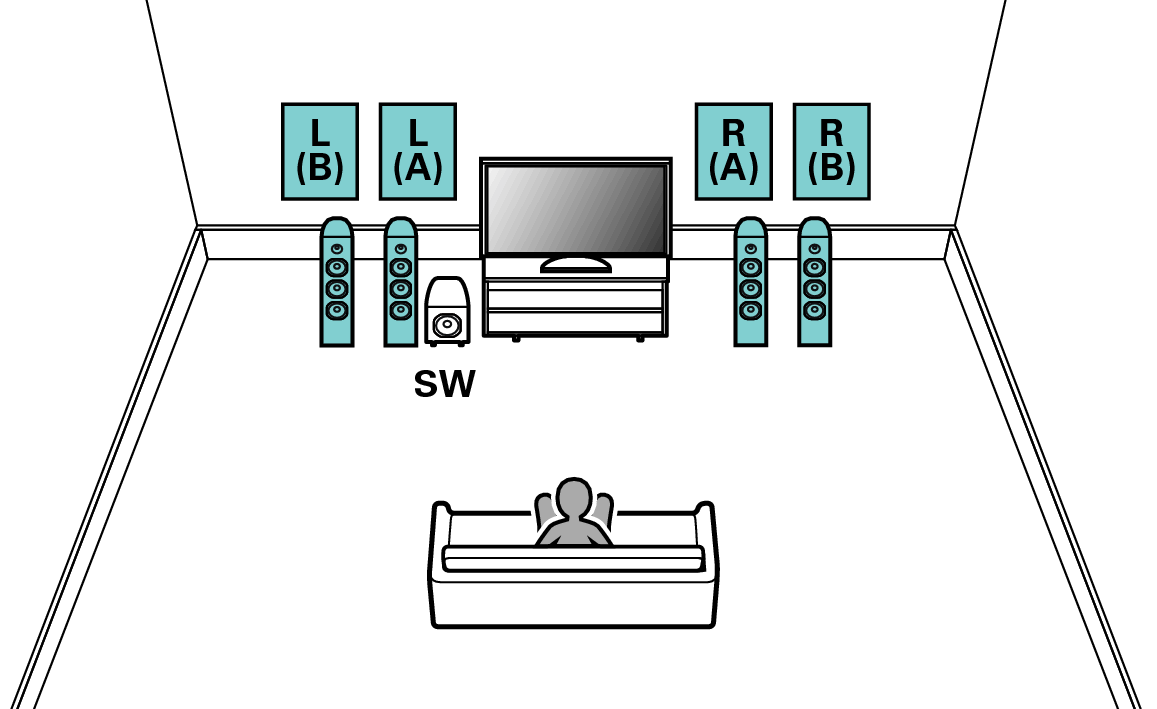

Just to muddy the stereo 70s question further, there are two statements in the manual:
“This system enables switching playback between speakers A and B as desired.”
Pict AmpAssign 2.1 FB
Followed immediately by:
“CAUTION:
Set speaker impedance to “4ohms” before performing simultaneous playback from speakers A and B”
If it can do simultaneous as well, the manual doesn’t seem to enlighten as to how!
