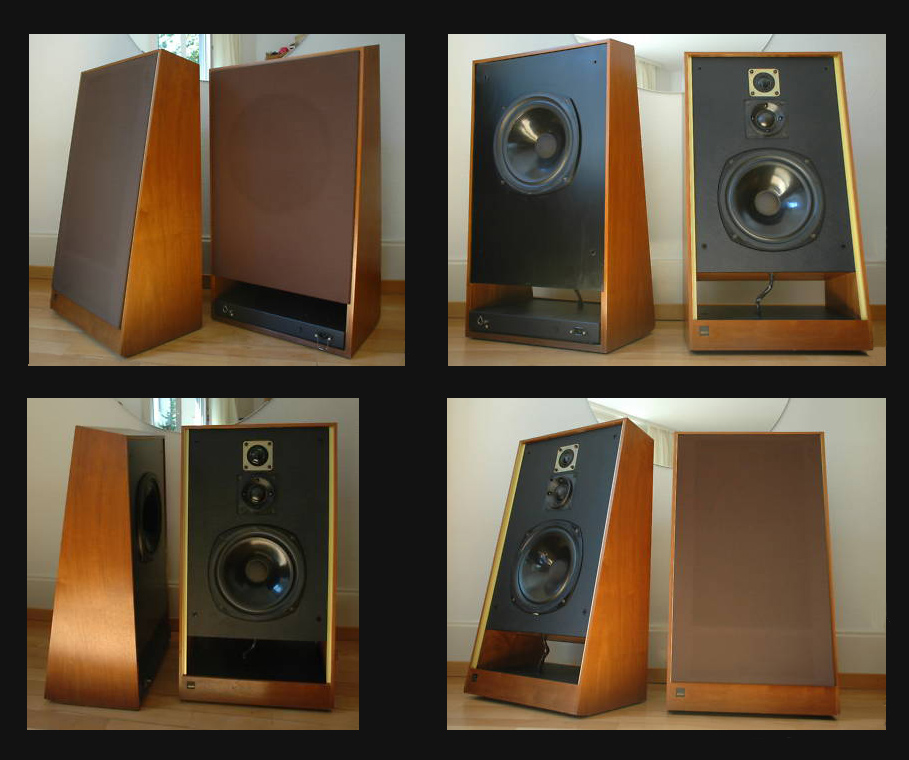

Some standmount speakers are designed to be tilted up, that's to say the stands they come with give them a few degrees of elevation. These for instance (sorry, I couldn't resist):

Chebby, thanks for the pictures.
When I was asking the original question, I remembered that some speakers were designed this way. Clearly, PMC, Neat & others have done more than experiment with this!!
