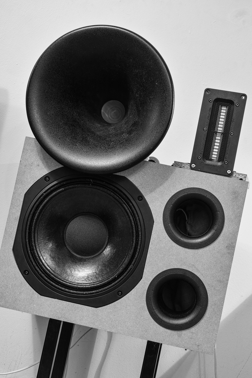

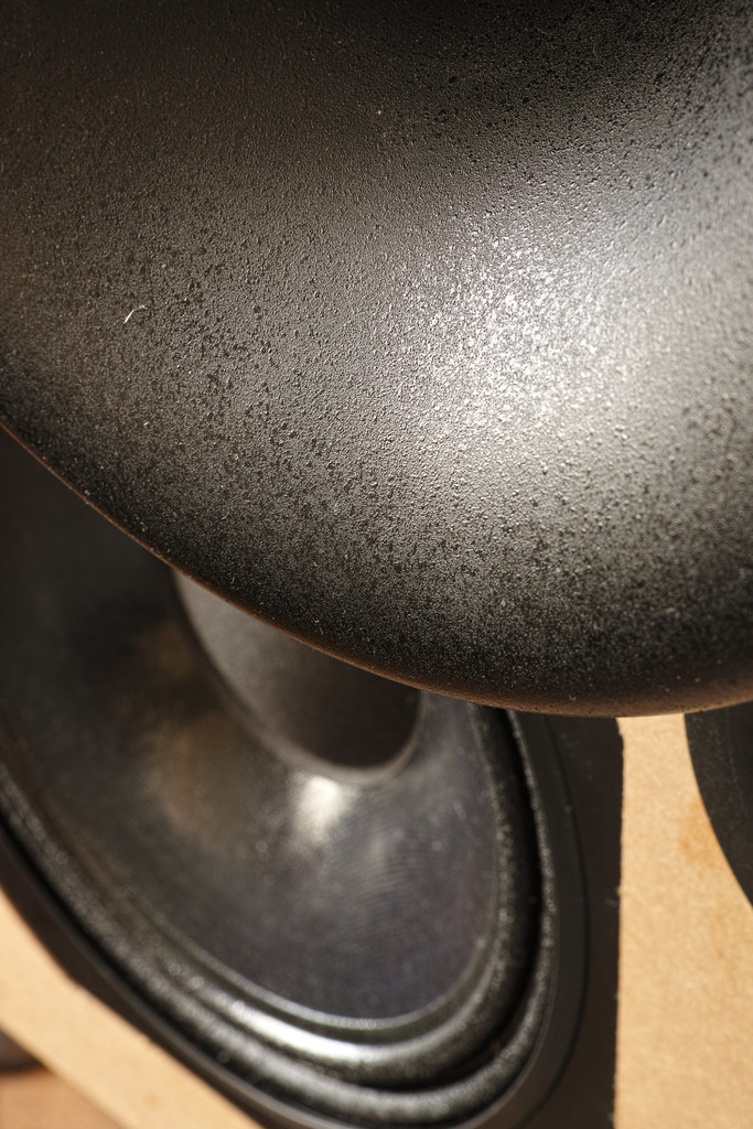

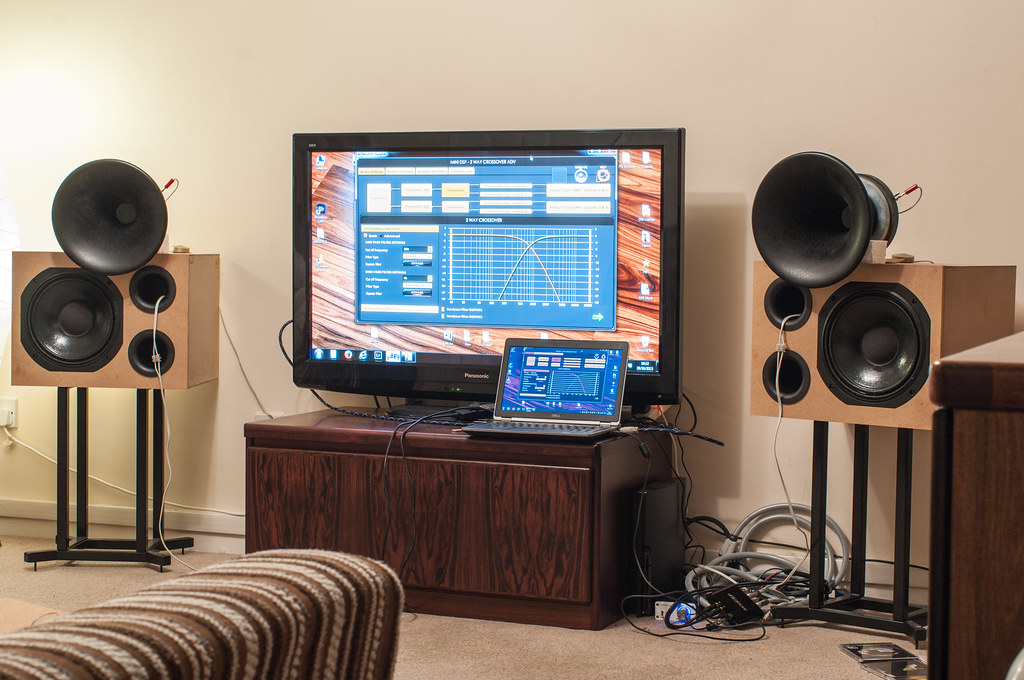

An update:
THe V1 configuration has really taken off:

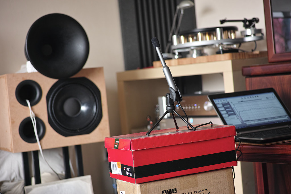

I have started measuring too:
Total Resonse with crossover @1m (Right speaker)

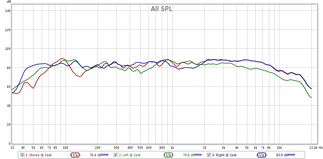

Total Response @ Seating Position (Right, Left and Stereo)
Is that the best microphone? Would need to order it from US. Any)hing as good in uk?

The MiniDSP UMIK is only $75 + Delivery from Hong Kong. it worked out at £100 inc Import duty/VAT etc.
Its similar to a Behringer one IIRC, and there are europen dealers for the MinIDSP stuff.
The good thing about it is that its plug and play, USB cable straight into laptop, download the REW software (Free) and away you go.

This means I can get the ribbons up and running as well, so we are a proper 3-way with active on the Bass/Mid and passive on the Ribbons crossover @5.5kHz
On top of that I have been thinking long term about the speakers, the short of it I dont actually like the 'tweakability' of the MiniDSP, I was forever changing little bits and not really listening to the music, so having a think about it over the festive period.

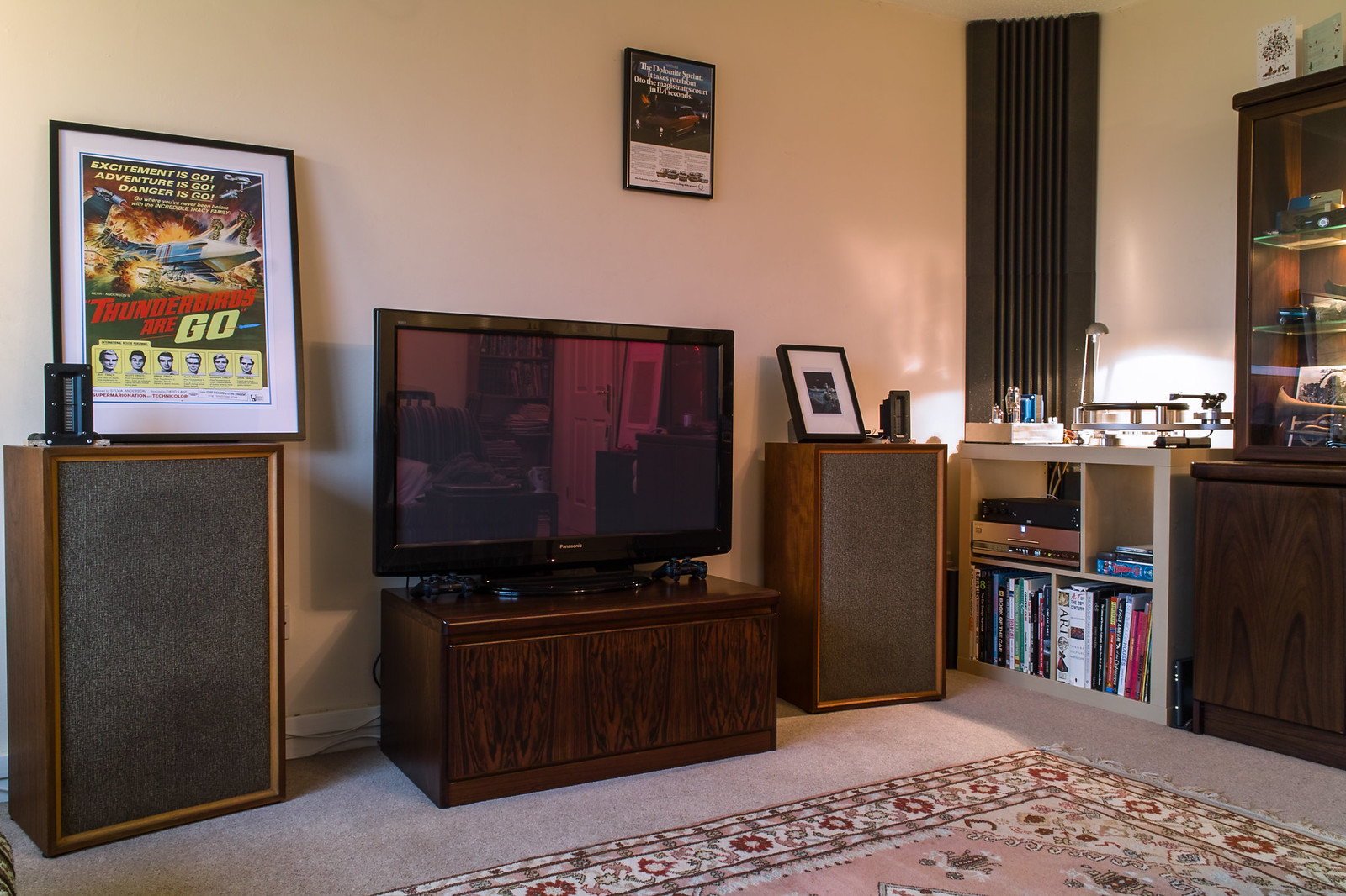

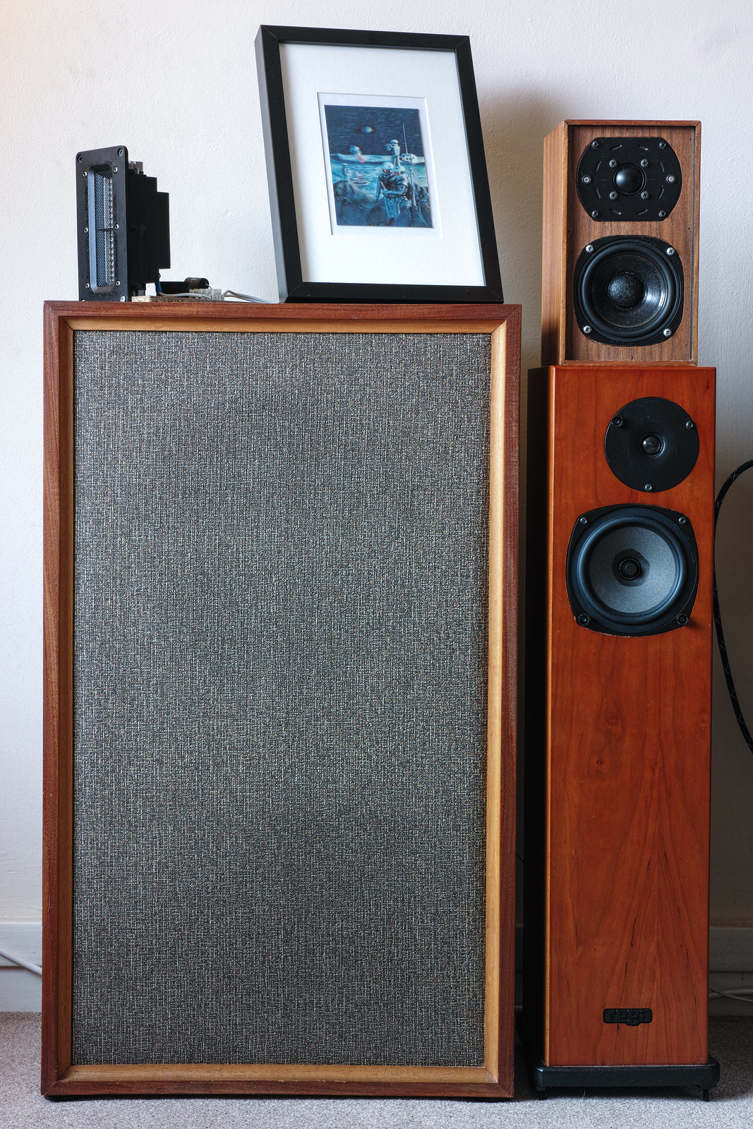

Was offered some nice, big, old and efficient speakers which I picked up at the weekend, an interesting complement to the Alyas and Kolts:
Some late '60s Goodmans Axiom 201 drivers. They are 12", wide range up to around 10kHz (probably, at a push) and came with a ~80Litre ported cabinet, which is quite well made considering th age.
They integrate really well into the room, and have a really nice unforced presentation but still retain good dynamics and bass punch. Not the deepest bass, as you would expect from the age and high efficiency (~96dB/15Ohms).
I have re-used the ribbon tweeters running from around 7.5kHz and up to help with the treble, really does help a lot and sounds quite good even with just a quick play!

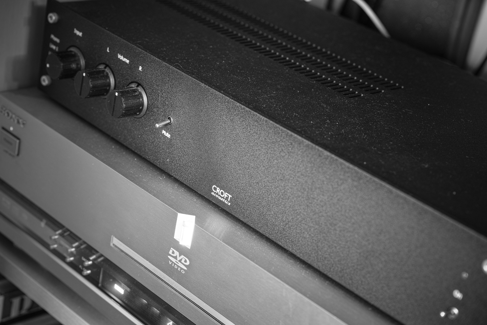

Found a Croft Micro 25 Basic going cheap, which will replace the AN Zero Pre, as well as doing the MM input from the Gyro.

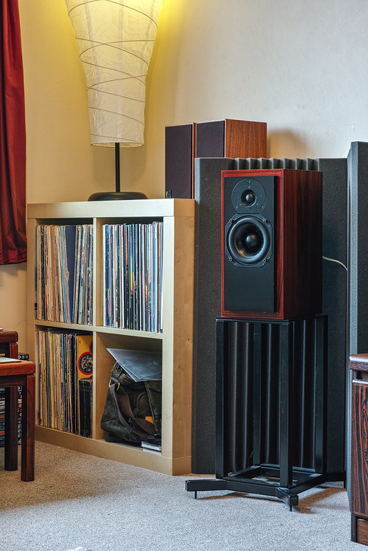

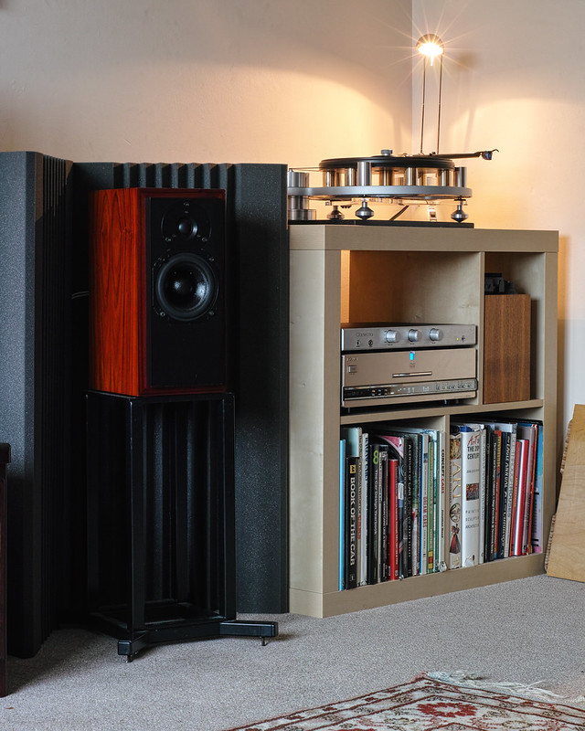

Hmmm, all change :rofl: These may look familiar from page 1 :rofl: They are the same pair of ATC SCM10s :grin:
Managed to keep in touch with the person who bought them off me, and have been umming and arring over the past 6 months or so if I should buy them back as he had them sat unused. 6 hours in the car later and they were mine, once again!
They will be joined by a Rega Apollo-R and Brio-R combo to try, hopefully the start of a smart, super simple (and easy to use) system 8)
RobinKidderminster said:
And a little room treatment. How is that working out?
It works well, I had these in the corners before but tried them first with the Kolts in this position and it works really well, seems to help a lot with the soundstage and bass depth especially.
Acoustic treatment behind speakers is a great idea, and as you say it can clean things up significantly. I have a GIK panel hanging behind each speaker. Which reminds me, I must get some photos up soon.
Yes, seen a few on the Wam and PFM.
Matched to the colour of your walls (white in my case), they're pretty unobtrusive. I now have three panels behind the listening position, which have helped to clarify the top end.
