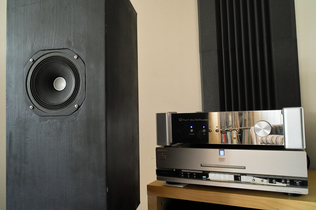

And a new Pre-Amplifier in the shape of a Doge 8. Its a Chinese Tube Preamp, pretty well reviewed in the USA. Will be partnering the Decware Zen when its finished.
Sounding very good indeed and plenty of scope for Tube Rolling with 4x 12AX7 and 4x 12AT7 inside! Lovely build/remote too.

Its looking good and sounding good 🙂

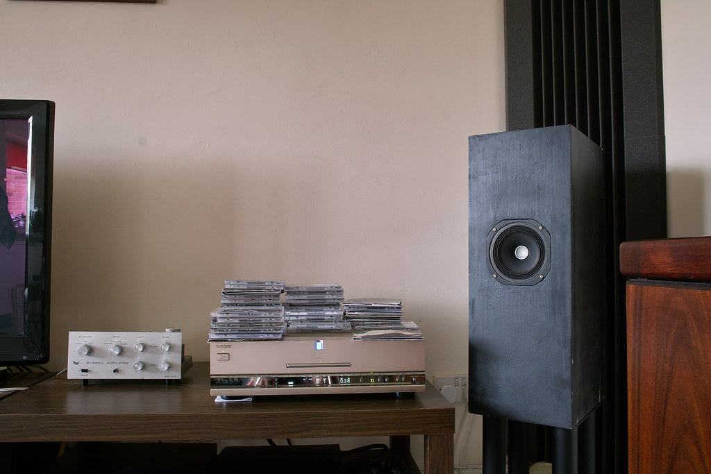

I think, much the same as the previous Decware built Decware Zen although different CDP/Pre and Speakers!
Only had it on for 3hrs so far last night and enjoyed it but that was 3hrs from being built.

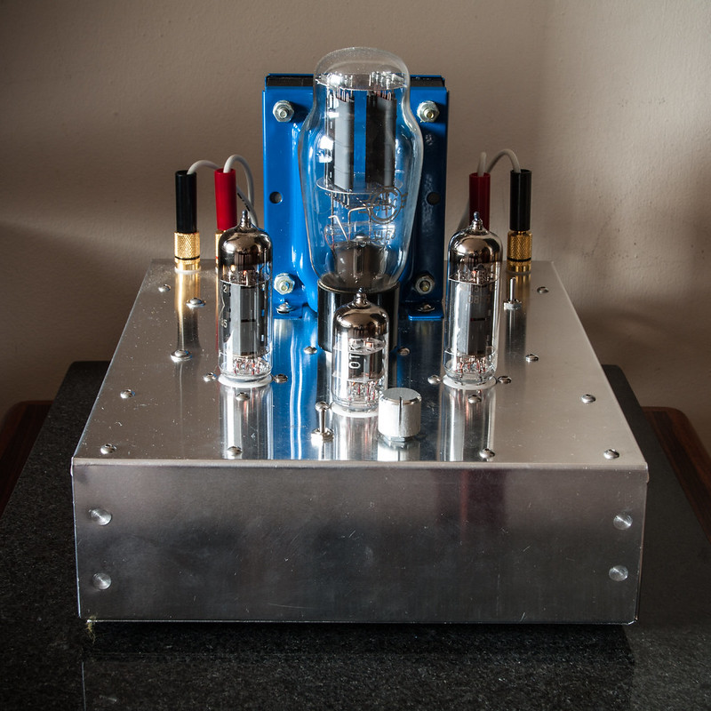

I cant take all the credit, a friend and member on another forum did all the design/layout and planning, I just copied his prototype.
This is the amp its based on:
http://www.decware.com/newsite/SE84CKC.html
Its a slightly different earlier revision with uprated power and output transformers.

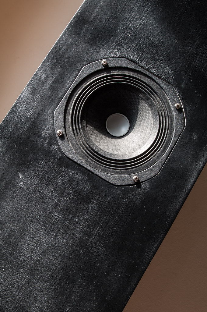

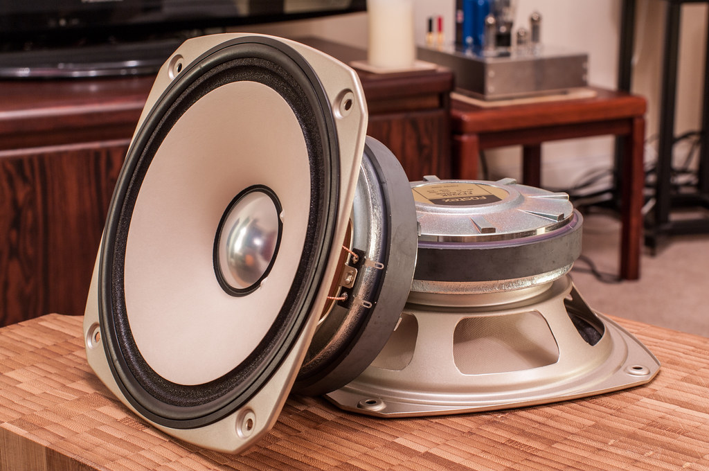

A few years back I had some massive horns with Fostex FF225K drivers in them, I found a pair of the drivers for sale locally and decided to give them another go. The plan was for a corner horn or similar but whacked them in OB to see what they were like and they are sounding really good at the moment, I have some tweeters to take over from them at around 6-8kHz.
They are around 96-97dB so perfect for the little Zen!

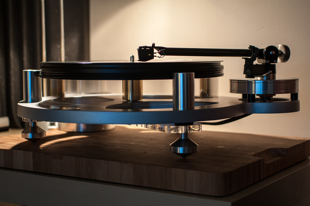

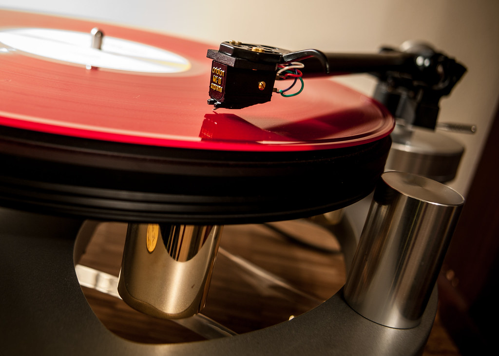

I also seemed to have bought myself a Michell Gyrodec :dance: I already have an RB300 and Ortofon MC 10 Supreme Cartridge to go with it when it arrives in the next week or so.

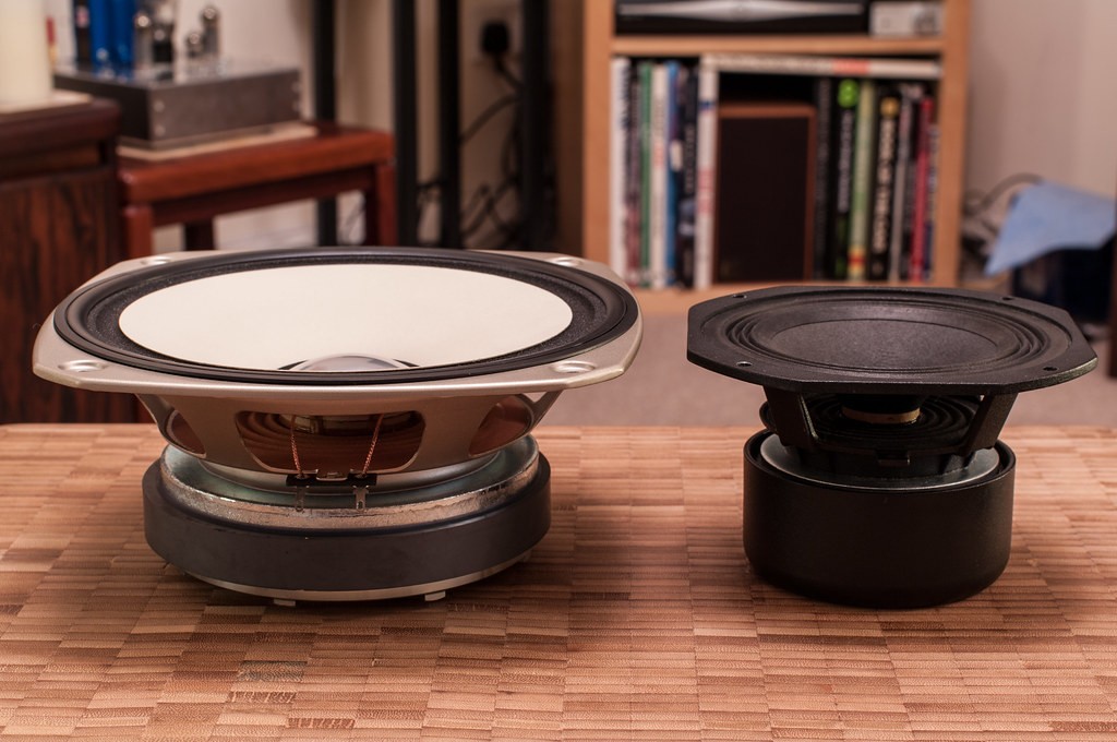

And compared to the Veravox drivers:
And the Fountek JP2.0 Ribbon tweeters:
And the test baffles:

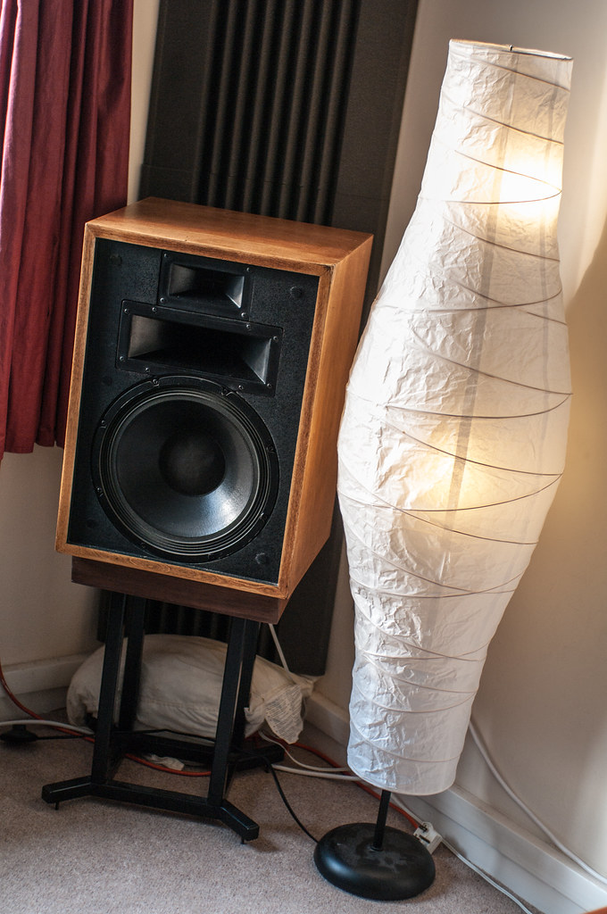

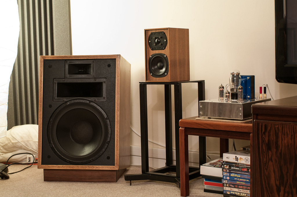

Klipsch Heresy II
I really liked what the OB speakers did, but not sure if I could live with them so far out into the room, much like the Magnepan MMGs, not sure my room is the best shape/size to really take advantage of them. I have had the Heresys on my radar for a long time, and a pair came up for a good price and I thought it would be a good chance to try some more speakers on my long-term to-do-list.
I only picked them up yesterday so no real impressions other than I thought they sounded a little dull/closed in until I realised I was listen at around 10dB lower than I would usually (~55-60dB) acording to the rough SPL meter on my phone, which I have used a lot before. They certainly dont have such a bright treble as some have described, so far anyway.
The cabinet is not the best, I can hear some colouration from that, and possibly some from the bass drivers top end (Lower range of female vocals) but moving them a little away from the walls helped a fair bit.
Plenty of experimentation to be had I think! They have already had the 'upgraded' crossovers and some new Mid-Range compression drivers.

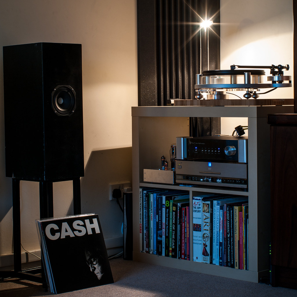

So back to my Veravox speakers for the moment, and a new toy was collected today and another Ikea peice to tidy it up a bit:

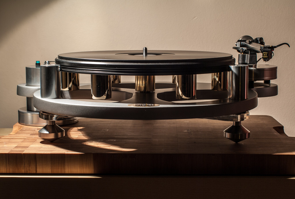

Correct VTA on the RB300 now with the Michell VTA adjuster:

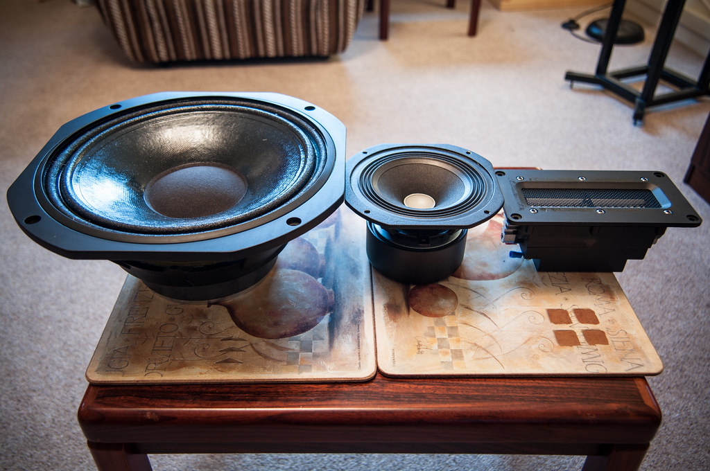

Volt BM251.3 Mid-Bass drivers:
With my current Veravox 5S wide-range drivers:

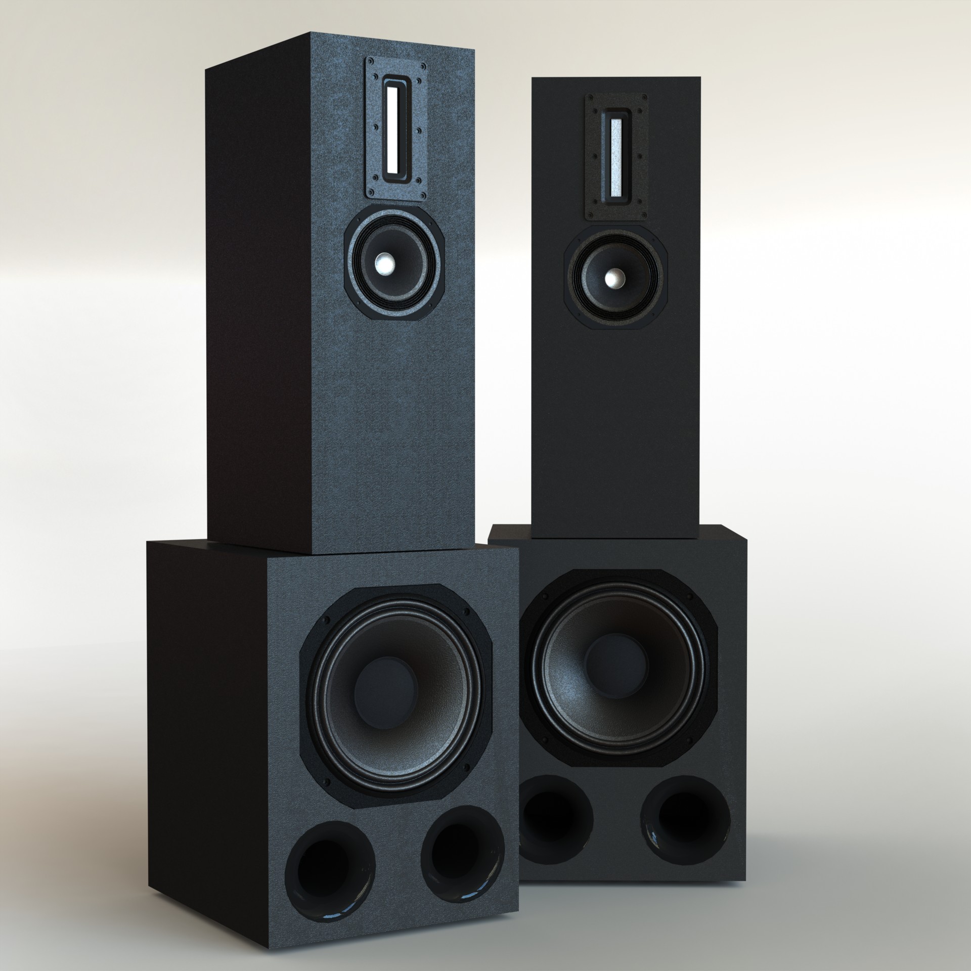

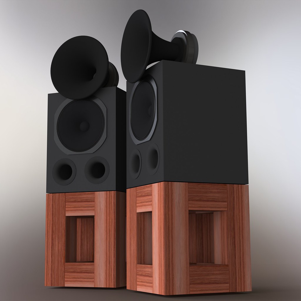

And had a lazy weekend, did a bit more CAD on the 3-way idea as above. Not the most detailed models but only spent an afternoon on it.

There will be two main configurations:
V1 - 2 way using a Volt BM251.3 Mid-Bass (<800Hz) and Radian 850pb compression drivers in a 400Hz Stereolab Tractrix horn (>800Hz)
V2 - 2.5 way using the Volt BM251.3 Mid-Bass (<300Hz) and the Veravox 5S wide range driver (300Hz-~8kHz) with a Fountek JP2 ribbon (passive >8kHz) on top.

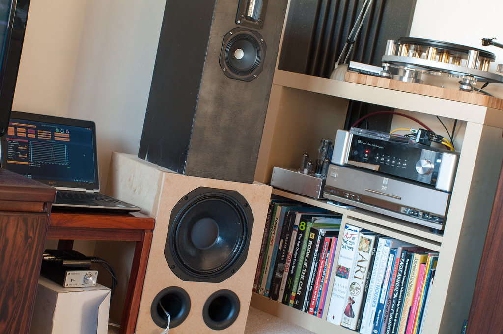

First up, the bass cabinet build. It was a flat-pack from Wilmslow Audio based on their 'Tornado' cabinet designed for the 8" and 10" Volt Bass driver. It comes with the cutout/rebate for the driver, and I have changed the port tuning to optomise it for the Volt driver.
Test fit:
Other cabinet and ports:
Halfway:
Almost....
Assembled and with the little Kolts for size:
Now, V1 will be using the Radian drivers, they are big beasts:
Comparison with the V2 drivers/cabinets:

And the V2 cabinet as per the renders:
And showing the test layout with the MiniDSP software, which I have just got working this morning:
So there we have it, now the hard part starts, getting a cohesive design!
