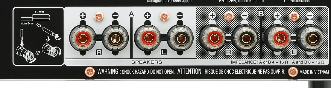

My explanation of the switchbox is how you read it. The amp will need to deliver more power when driving two sets of speakers due to the lower impedance. For this reason I can no longer use both sets of speakers at the same time in my system since switching to 6Ω speakers. It was ok with two pairs of 8Ω but not an 8 and a 6 as they are now.
As for the Stereo 70, I am suggesting that it would be the same as my amp, and the PM6007 where this thread started. My understanding is the .2 refers to two subwoofer outputs, not the ability to power two sets of speakers. See image below, it has the same AorB 4-16Ω. A&B 8-16Ω instruction that I have. I could be mistaken as I have no hands on experience of the amp.
