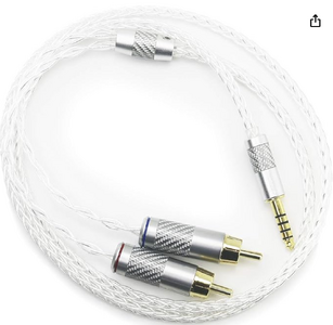

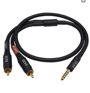

Just buy a 4.4mm balanced to 2 x RCA adapter.
These are currently available at Amazon one is in the USA for $18, the other is Amazon UK for £28.

The two leads in the pictures above have RCA plugs - he needs Pentacon to XLR (or TRS) to make use of the balanced inputs on the speakers.
(We can't blame him for wanting balanced inputs on the speakers - when the ifi gives him balanced output).

The two leads in the pictures above have RCA plugs - he needs Pentacon to XLR (or TRS) to make use of the balanced inputs on the speakers he's getting.
True, but he doesn't need to use a balanced connection unless he's running 100 feet of cable in an EMF rich environment. Converting the balanced to unbalanced will do just fine.
