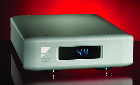

unleash_me:
Ayre Acoustics QB-9
Nice. I'll start saving before I audition it though...
"If you haven't heard it, you don't have an opinion." - Ivor Tiefenbrun
I disagree. My opinion on the QB-9 is similar to that for most audiophile gear costing over a £1000/unit: I bet it's lovely but there's no way I'm being allowed to have one, not until the house is finished, estate replaced and those exotic holidays have been had. At the very least...
